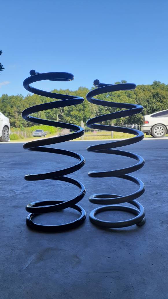

Just got the Wheelers springs (T12). Heres a side by side with the Eibach kit. Maybe you're thinking of the T13.
Sent from my SM-A205U using Tapatalk
Yes, correct. I think the T13 which is marketed for 1.5” is same in length as this eibach pro rear 1” spring.

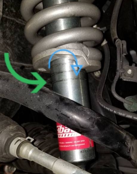

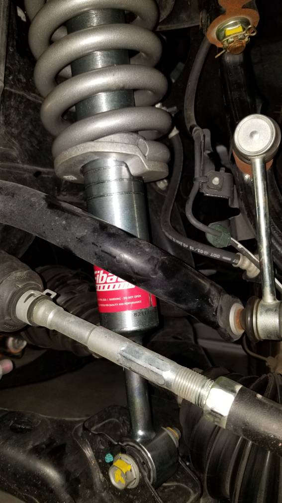

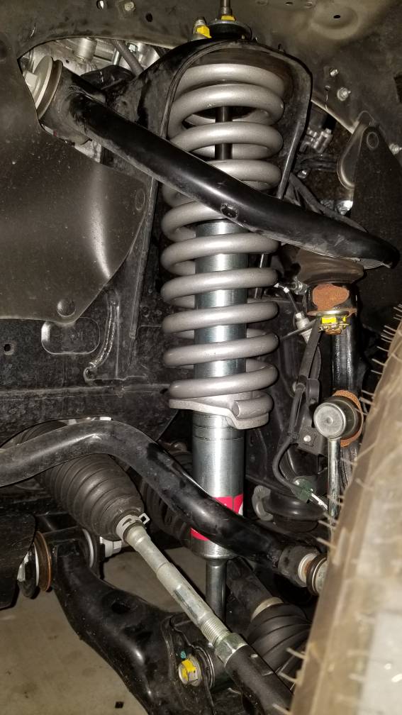

Had the lift installed today. These are my before and after measurements while sitting in my garage. Does it appear to not be on the bottom notch?
LF-B: 34½
LF-A: 38⁹/¹⁶
RF-B: 34 ¹⁵/¹⁶
RF-A: 38⅜
RL-B: 36⁹/¹⁶
RL-A: 37¼
RR-B: 37¹/¹⁶
RR-A: 38⁵/16
Sent from my SM-N950U using Tapatalk
I would think this is the bottom... Especially since you have more lift than advertised.
Agreed. I spoke to the place that installed it and they said to bring it back next week and they would have to take it back off to make the adjustments and do a realignment.
Ryan, is this true or is their an easier way to make adjustments?
Also, would it be correct to assume measuring from the top line to the bottom line will tell me how much height I will loose after adjustment to lower line?

Reverse Rake on the top notch:
I can't say I've read every post in this thread but darn near most. Many questions relate to the perch settings. I couldn't wrap my head around how the lowest setting was going get get the max claimed 2.5" lift. How would the other settings not provide higher lift?
I'll attempt to explain so others in my shoes may have a better understanding. Please correct me if I'm wrong and of course disregard lol.
Many of us are comparing and shopping the Eibach kit against the Bilstein 5100's as apple's to apples. This Eibach kit comes with a taller than factory spring which would provide a lift if even just mounted on a factory shock, whereas with the 5100 the lift comes solely from the perch settings using a regular factory length coil. Kind of apples and oranges.
Obviously if you you use the higher settings on the Eibach it will lift it higher, but that is only designed to compensate for additional weight of accessories such as bumpers. Winches etc.
In order to get the maximum advertised lift out of the 5100's you HAVE to use the upper setting.
