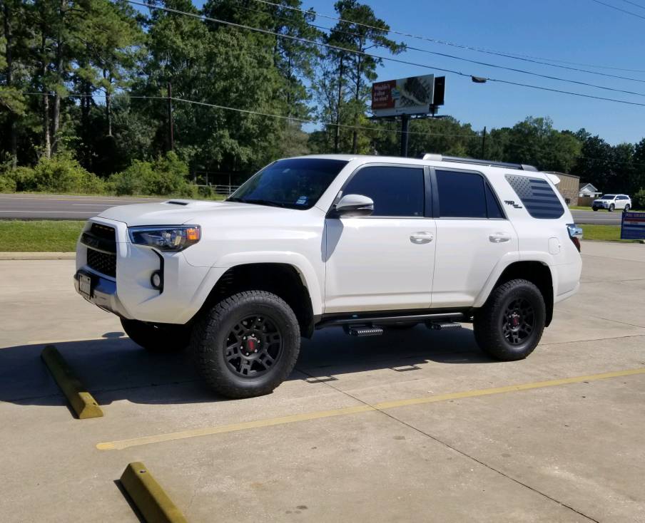

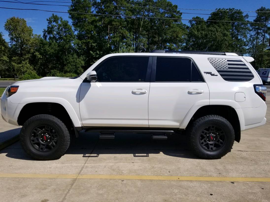

I can't say I've read every post in this thread but darn near most. Many questions relate to the perch settings. I couldn't wrap my head around how the lowest setting was going get get the max claimed 2.5" lift. How would the other settings not provide higher lift?
I'll attempt to explain so others in my shoes may have a better understanding. Please correct me if I'm wrong and of course disregard lol.
Many of us are comparing and shopping the Eibach kit against the Bilstein 5100's as apple's to apples. This Eibach kit comes with a taller than factory spring which would provide a lift if even just mounted on a factory shock, whereas with the 5100 the lift comes solely from the perch settings using a regular factory length coil. Kind of apples and oranges.
Obviously if you you use the higher settings on the Eibach it will lift it higher, but that is only designed to compensate for additional weight of accessories such as bumpers. Winches etc.
In order to get the maximum advertised lift out of the 5100's you HAVE to use the upper setting.
How'd I do???
Sent from my SM-A205U using Tapatalk
You have it correct. The Eibach coil is where the lift comes from. Without the coil, it'd be similar to a 5100 with different lift height based of where you put the snap ring
