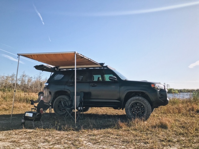

Just got my kit installed, so impressed! So far its 3in front and 1 in the rear. Love the look and handles so much better. Now for bigger tires

Oh yeah. She is crying for bigger tires. What color is this.Wrap , painting? Really nice!
Yeah I guess. See. I had a spacers before I threw Kings in there and never did measurements “ before and after “just forgot. 650lb coils up front and 0 preload Should be 2.75” and Eibach 1” spring on the rear. Thanks

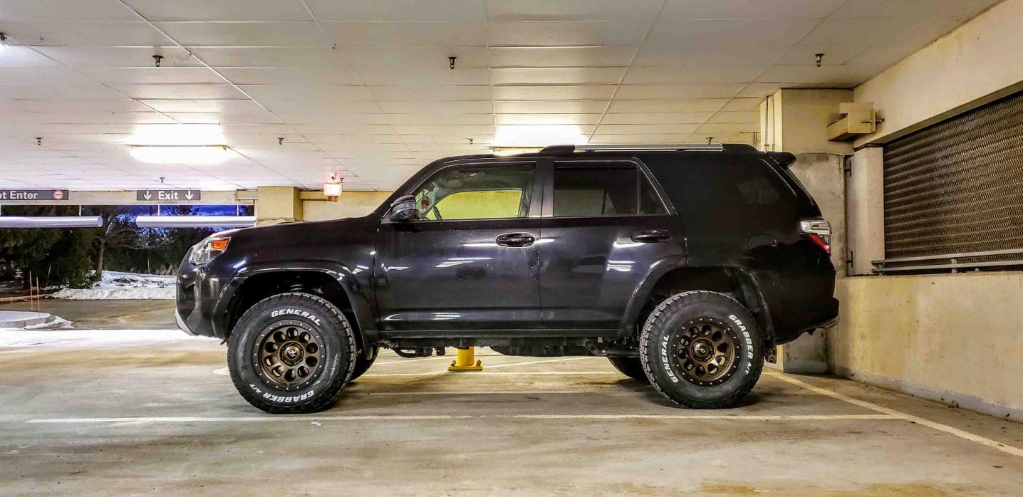

Finally got the wheels/tire mounted over the weekend.
First time seeing it got me as excited as when I laid eyes on the T4R back in 2015.
Lift: Eibach Pro-Truck Lift
Wheels: SCS Ray10 Bronze 17X8.5
Tires: General Grabber AT/X 275/70/17
Noticed there is rubbing at full lock on the front mudflaps - will take a heat gun to it or remove altogether.

That looks perfect.
