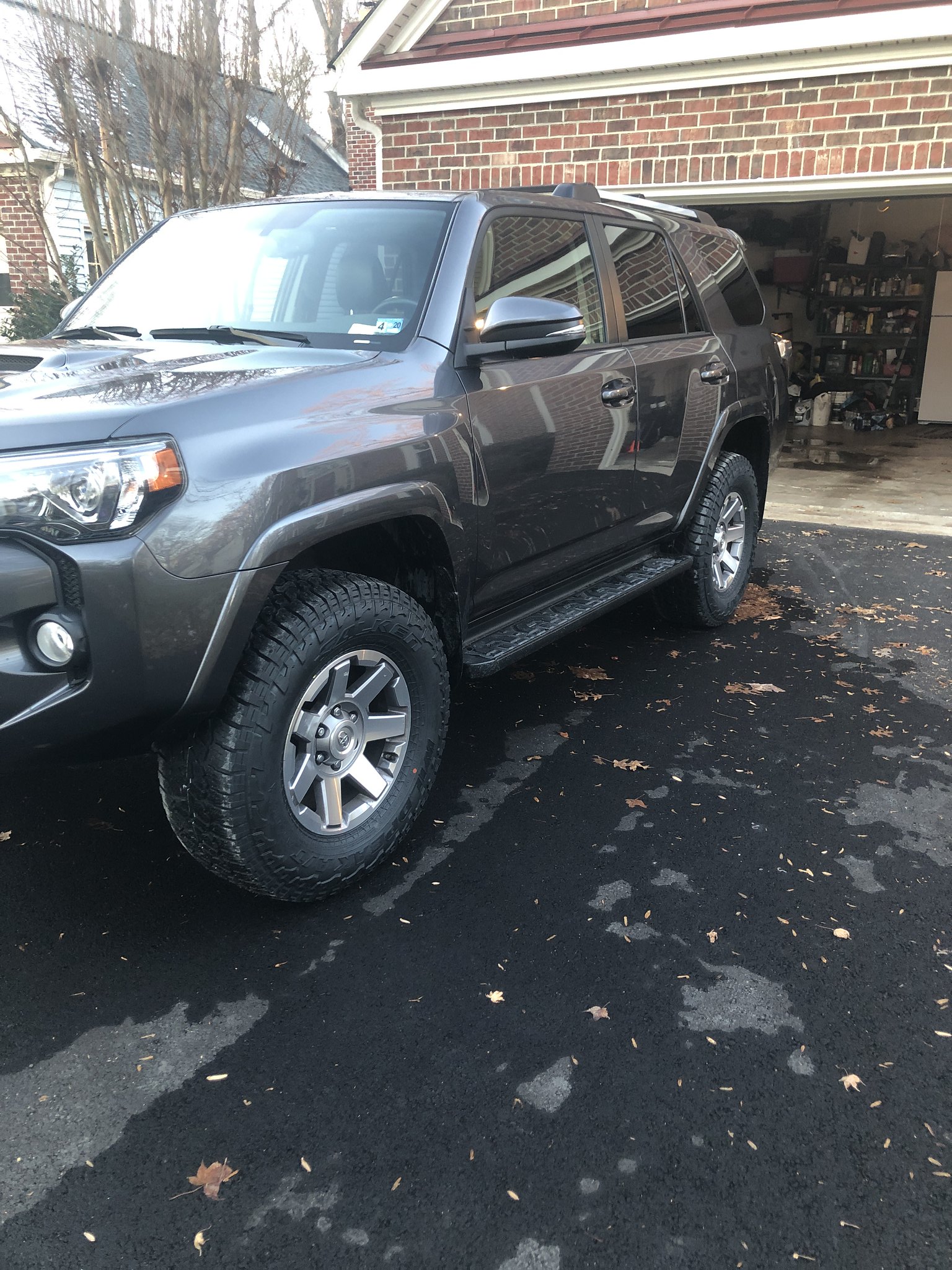

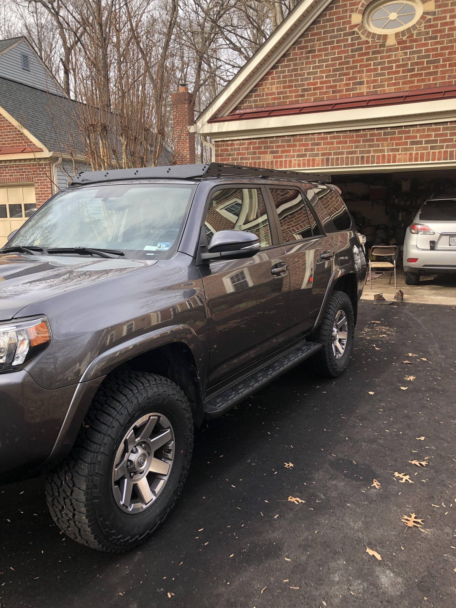

Since I b!tched so much about the kit taking forever to get to me over the summer, it’s only fair that I come back to the thread and provide my experience with the lift after a few months of use. Simply put, Ryan and the folks at eibach have killed it. The ride quality is fantastic, nose dive is all but gone, and the 4Runner feels more put together going through corners than ever before. I threw a couple of pics up compared to a stock runner and then last weekend after I installed the Prinsu. The fronts are set on the lowest clip and have zero rubbing with no trimming or fender liner modifications on 285 AT3W’s. Can’t say enough about how great the lift is from ease of install to quality.

Super mild and perfect all in one.
