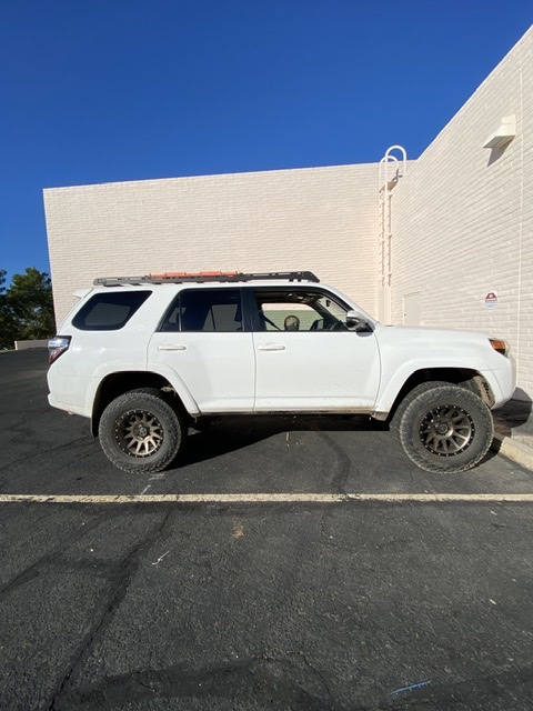

Welp full circle. Decided to keep my truck mild after all. Looking to swap my rear springs.
I have a dobinsons 2.5" lift up front. Love the height don't really want to muck with that.
Rear I'm sitting at 1.75" of lift so I have a bit more rake then factory. Looking to try to level or a slight rake. Was thinking about swapping the rears for the Ebiach Pro 1" coils (might be a tad softer).
Would this essentially have my truck at the same measurements as the full pro kit? "Level"
If you decide to go this route, I’ll sell you mine. About 3k miles on them.
That would be pretty close to level, IMO.
I'll second that being very close to level.
I have my fronts set at 1.6" and my rear end is at 0". I still sit 1/4" higher in the rear when doing middle of hub to bottom of fender measurements.
Perfect stance, IMO.
What was it that caused this change of heart? Did you get heavier Dobinson springs in the rear and they were too rough?
