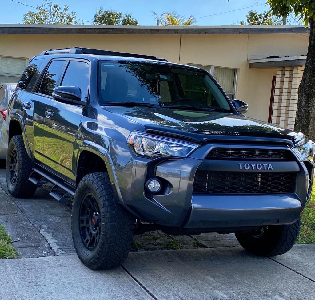

Finally got the wheels/tire mounted over the weekend.
First time seeing it got me as excited as when I laid eyes on the T4R back in 2015.
Lift: Eibach Pro-Truck Lift
Wheels: SCS Ray10 Bronze 17X8.5
Tires: General Grabber AT/X 275/70/17
Noticed there is rubbing at full lock on the front mudflaps - will take a heat gun to it or remove altogether.

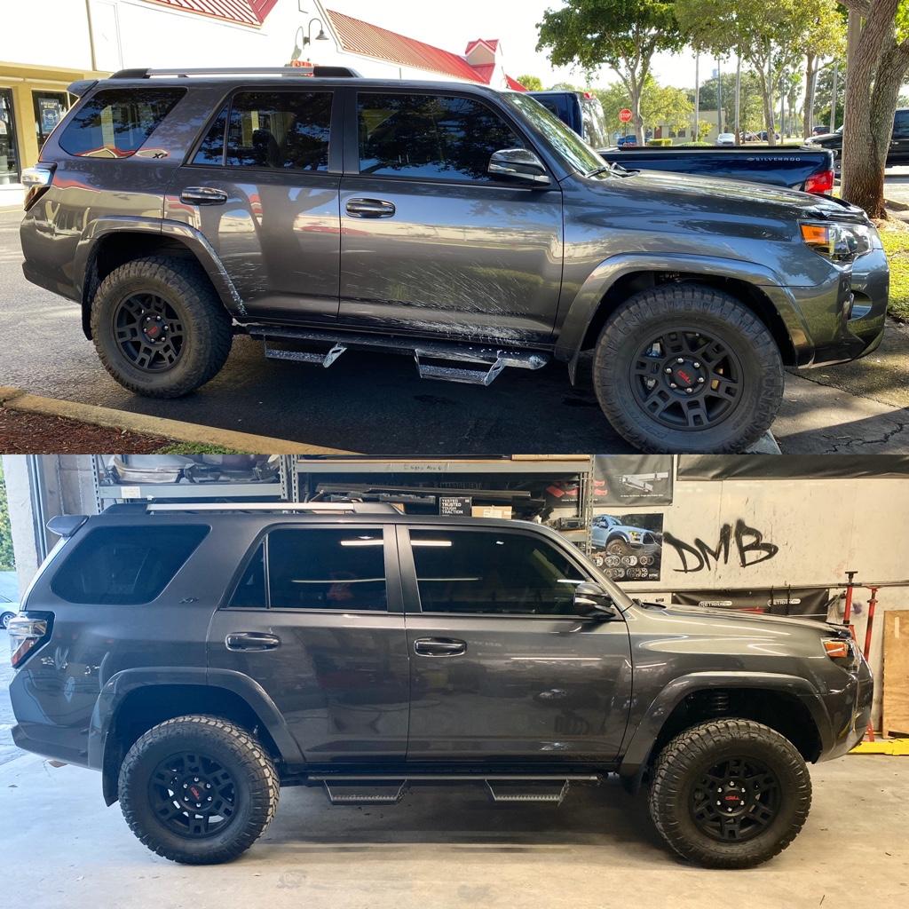

Do you have any pictures from the front and back to see how the stance of those wheels will look like, planning on ordering those wheels and risk to see if 285/70/17 tires will fit without heavy modification and this suspension lift kit. Thanks. Awesome 4Runner!
Here you go fellas my kit was finally installed really love the ride and height of this kit. Front and back was done.
After it all settled what is your final height?
