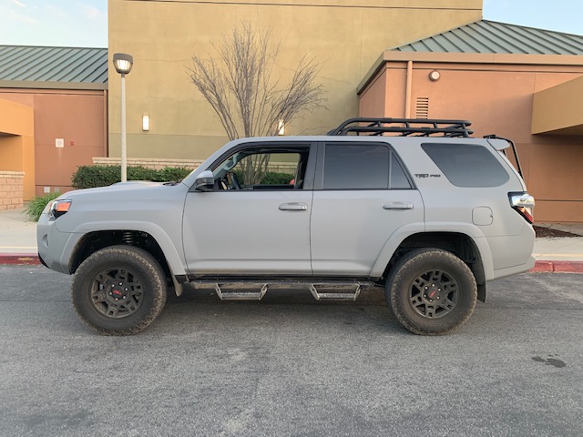

I had it installed on SR5 (no rack or bumpers)
I swapped over to Wildpeaks AT/3 (265/70 R17 (factory size))BEFORE the lift. I did this so i would NOT be tempted to go larger.
MPG before the lift was 19 - 20 highway commuting, 17 - 18 mixed and 16.5 - 17 if i only drive around town.
MPG after the lift - basically same.
one observation (noticed even by my wife) is the 4Runner RIDES MUCH BETTER. Way better than stock, no leaning in turns, no nose dive.
also, i too considered 275s. I found the the 275 were LT tires. These tires weighed way more the the 265s. I knew from my days of 350z ownership, that extra "unsprung" weight kills MPG and acceleration. Hence the 265 wildpeaks.

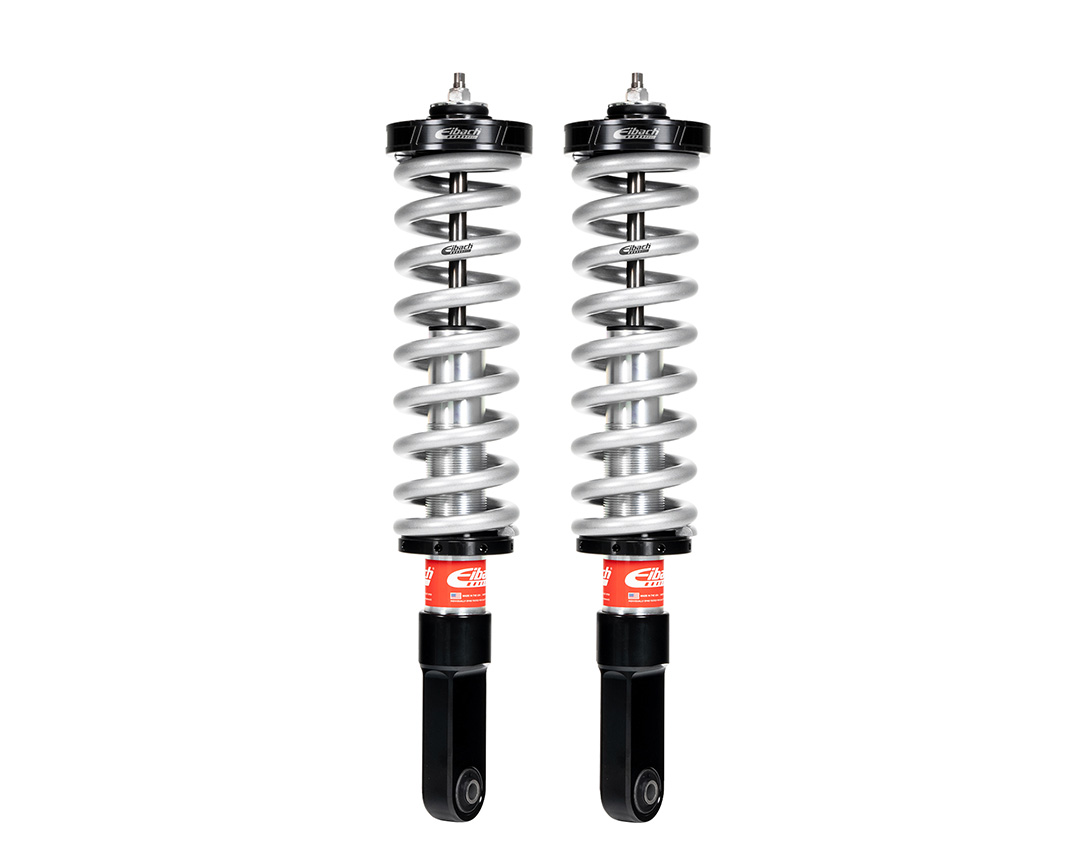

Woah there really are fronts in the works!? Ryan what’s the adjustment range on the front coil overs and rough pricing-ish?

Sneak peak. Bottom mount is going through a re-design.

Hey Ryan,
I'm also curious about the adjustment range on the new front coilovers.
Have you guys thought about rear shocks with compression adjusters? I'd be all over those.

I have this set up. The Eibach pro lift. 2.75 in front 1 in the rear. I personally love this set up. I also have the Dirt king ball joint upper control arms. My car doesnt look saggy at all...correct me if I'm wrong but I believe the 4runner is about 1.5" higher in the rear to accommodate a trailer weight, that way its leveled out if you have one hooked up. That's why by adding the kit 2.75 in the front and 1 in the rear wont make your car all "saggy".
And here our first TRD Pro lifted with factory fox shocks! I'm pretty stoked on this kit. It really brings the PRO to life.
This is about 1.6" of lift in the front and 1" in rear. You'll be able to buy this as a four spring kit or just the fronts if you wish. Pricing TBD.
