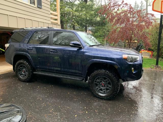

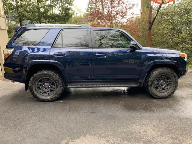

kit installed yesterday, only has 4 miles on it from the drive home from install.
2019 SR5P with third row
265/70 KO2's on TRD wheels
Before and after below.

Looking to do the same, what year you got?
Looks fantastic! How is the ride quality????
The ride home felt great (although 4 miles). I noticed the nose dive was gone and steering felt tighter on turns. I'd imagine that everything loosens up a little as the spring settle in but happy with the height and ride so far.
