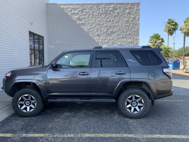

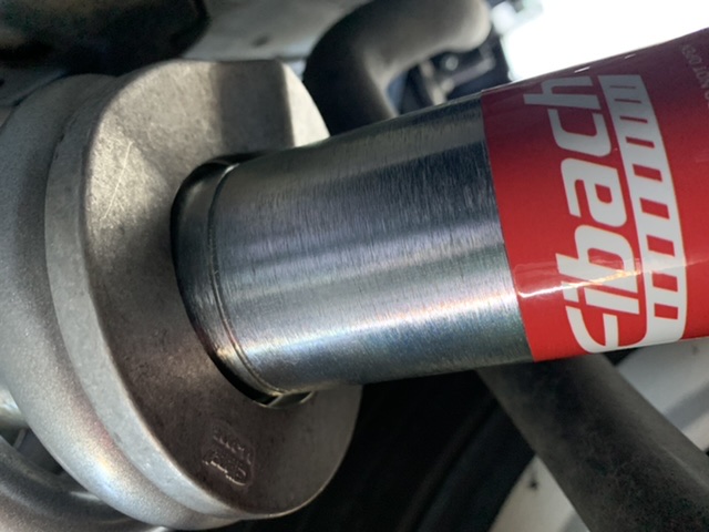

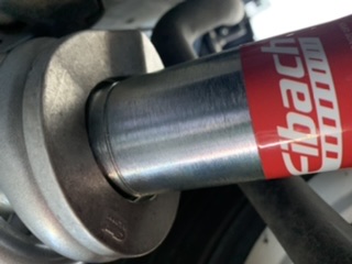

Just picked her up, but the counter was unsure which clip they set it at. Front is lower than the back. Attached pics for reference. Input is appreciated.
Doesn't make sense to me, you are not on the lowest clip setting, front should be higher, are those Eibach springs? From the pro kit?

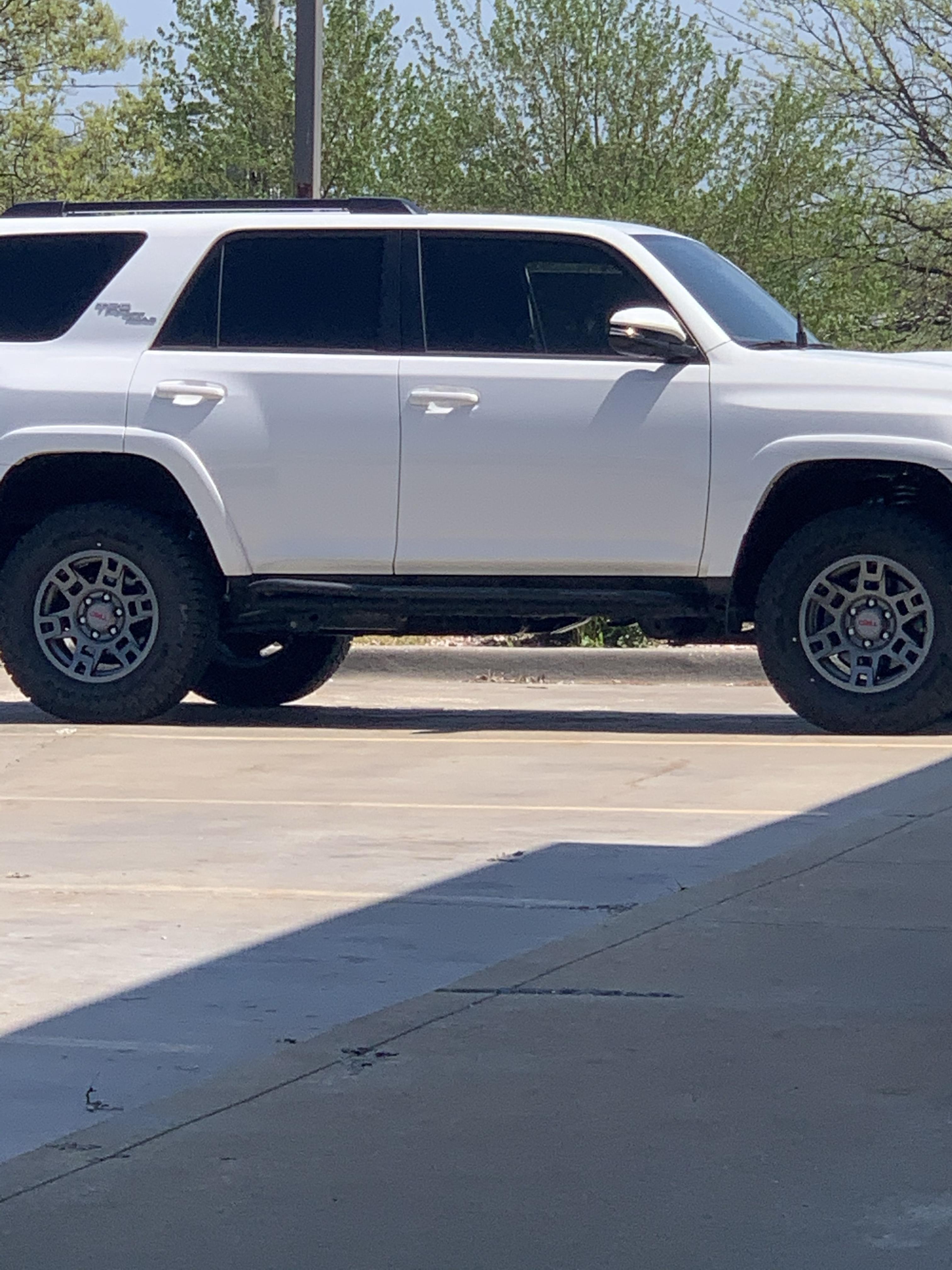

I got my Kit last Friday and would like to confirm my intended lift goal for my 2020 TRD ORP non KDSS. My 2018 TRD ORP w/KDSS I had Blistein FJ Pro kit with Toyota Baja 1" perch spacers(2" front lift) and Dobinson 1.25-1.5 rear coils. I liked that look and on MBT trips and family outings I didn't squat the rear too much with gear. So for my 2020 I ordered the Eibach pro lift and cornfed 1/2" spacers for the rear. Looking to get 2.75 front and the 1.5 rear. I didn't want the level look seeing in put bikes and gear in the back with up to three adults....
I believe 2.75" front and 1" plus 1/2 cornfed spacers will give me what I think I need...
Wheels are SCS Stealth 6 with 275 70 17 BFG K02s
