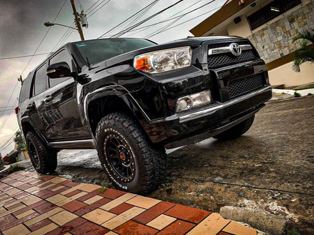

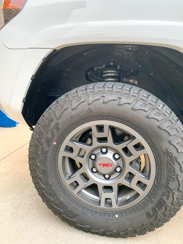

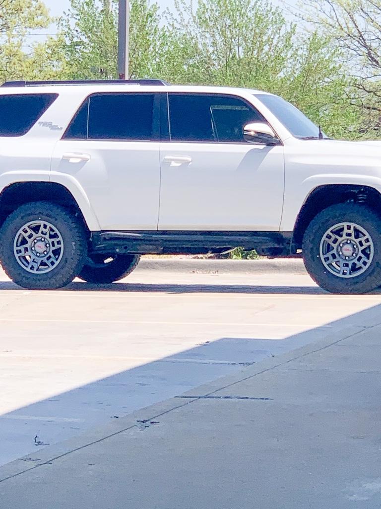

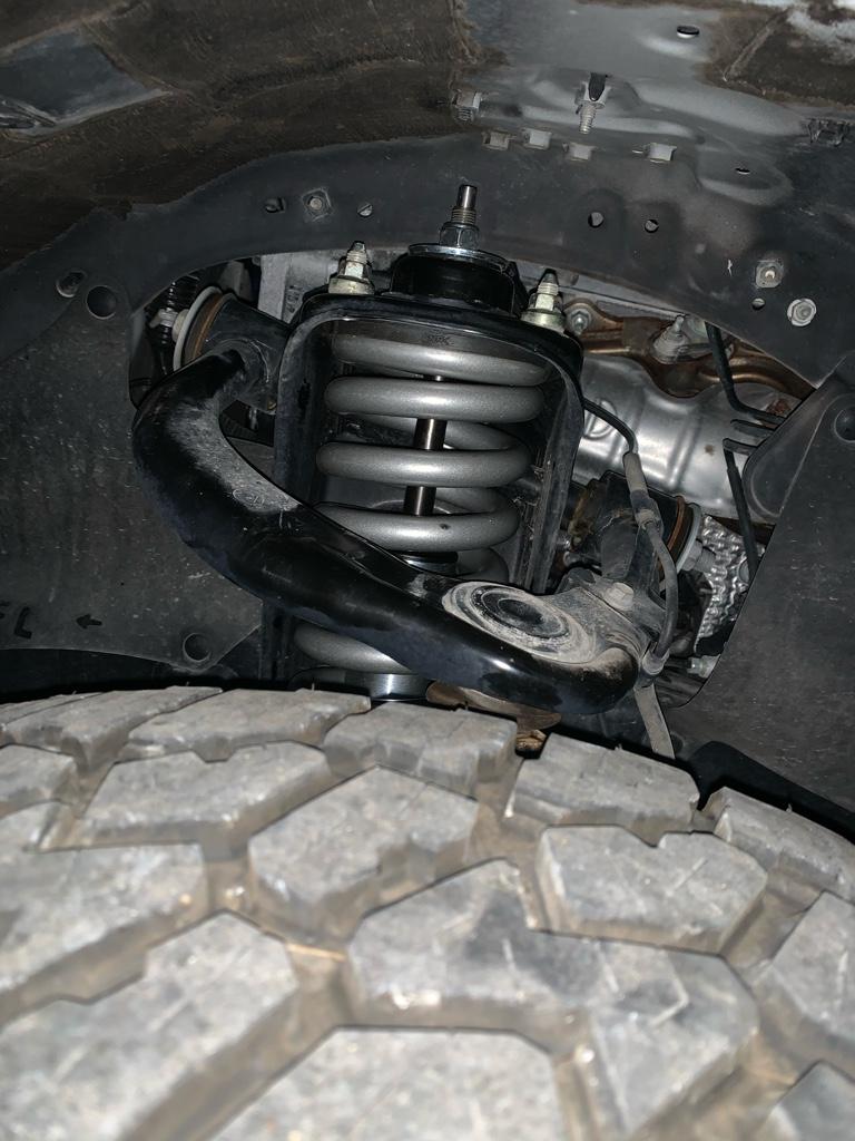

Put the old rims off my Silverado 1500 on the Runner this evening. They are 17x9 American Outlaw wheels with 285/70/17 BFG KO2 tires. They easily fit. I have about an inch from the tire to the UCA. I may just keep the wheels and put some new Falken ATW3 tires on them. It got dark on me and I couldn't get a pic with all 4 installed.
Has anyone had luck buying a set of TPMS sensors off eBay? Discount wants 45 bucks for each sensor and the bay has whole sets listed for 50-60 bucks.
Edit: The wife managed to get a pic with the wheels and tires on. Its definitely more aggressive and less grocery-getter.

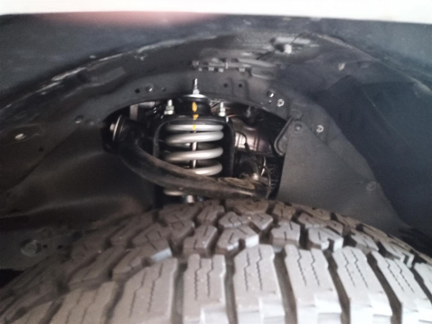

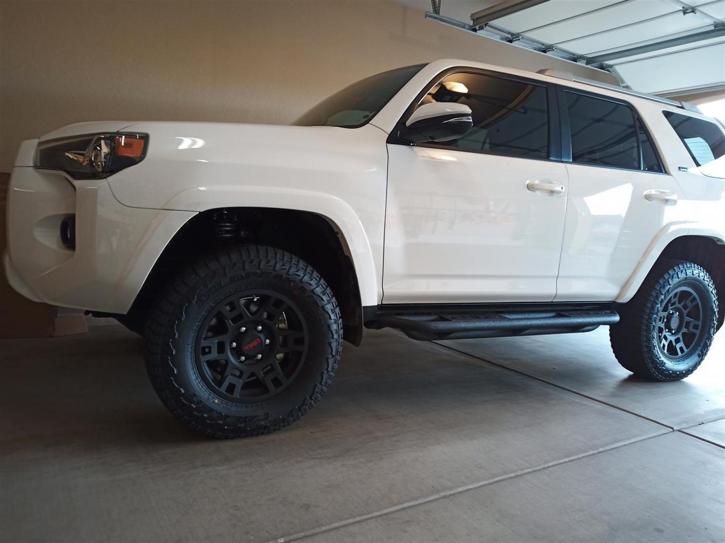

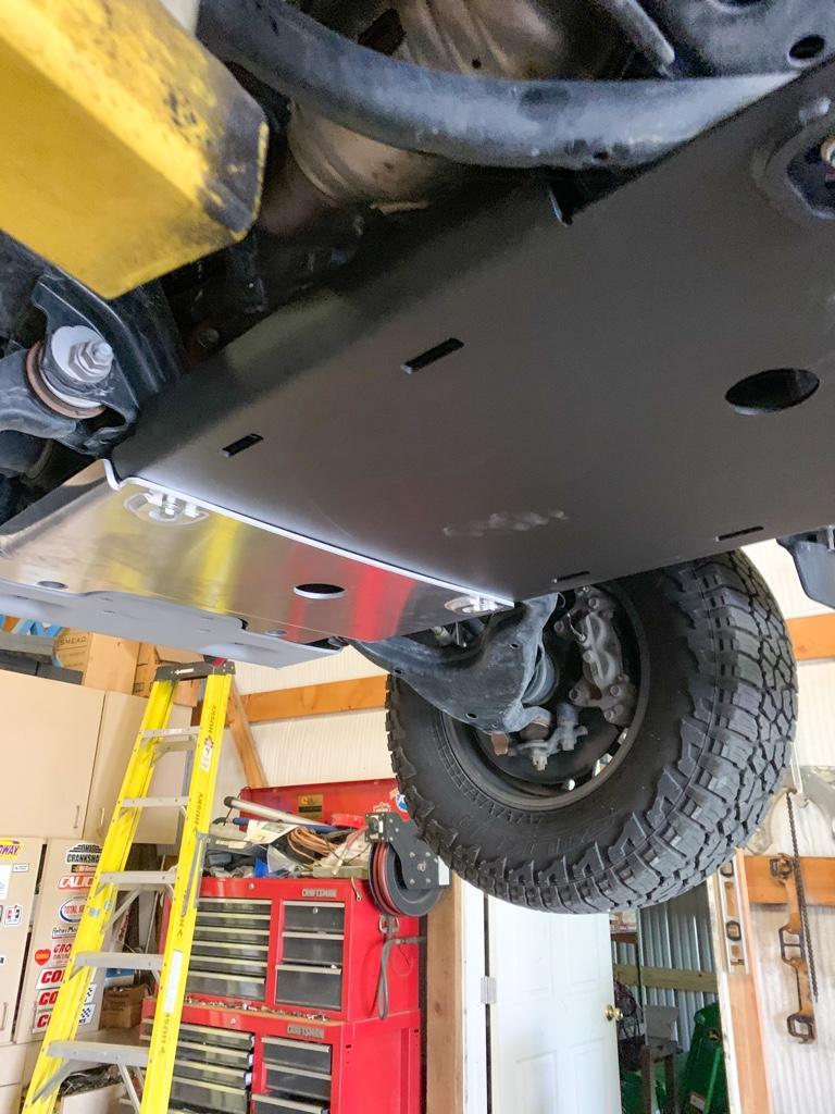

Finally got mine installed! I also added RCI skids (integration, transmission, and transfer case )
Congrats! You will love the way this lift rides. I need some skids and sliders as well. Thinking about the ARB skids since I can get free shipping from Amazon and they are the least expensive.

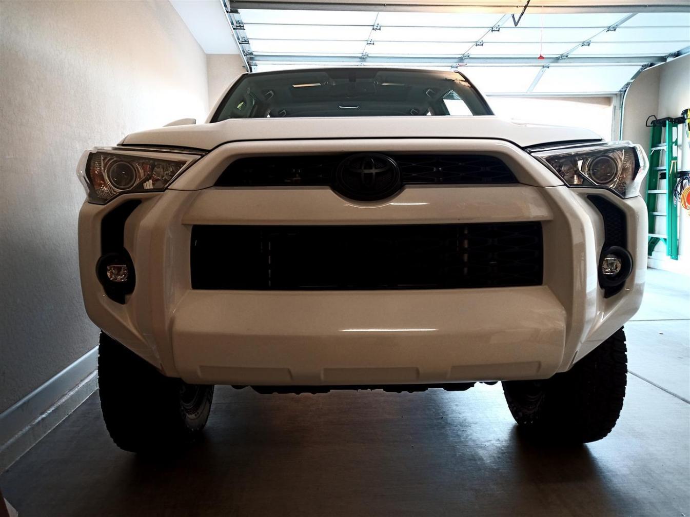

Lets see,
White 4Runner, TRD Wheels, Wildpeaks & Eibach Pro Lift....
Great minds think alike: :thumb3:

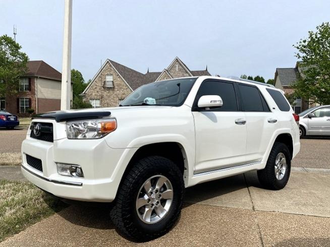

Another SW here. Pro Lift installed last week. Whimpy stock tires will stay on for a while...

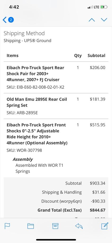

Anyone .5" or 1.0" rear spacers with this kit? Most of these lifted rigs look higher in the front and I would want my rear to sit slightly higher. Trying to get the most comfortable set up and other springs at 1.5-2.0" are the opposite of comfy.
Don’t waste money on spacers when you can just order it the way you want. I pieced mine together at Wheelers Offroad, assembled and shipped it was $844. I opted for the OME 2895E 2” rear coil as I didn’t want reverse rake when towing.

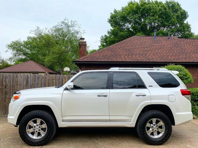

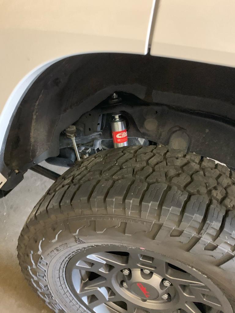

Finally got my Eibach Pro lift on. I was running 265 stock tires, decided to bump it up to 285's falkens and so far the handling and ride on these eibach pro's are super nice.
here is a couple of pictures I took with the 285's and the lift kit on.
Next purchase will probably be some RRW wheels whenever the bronzes come back in stock.

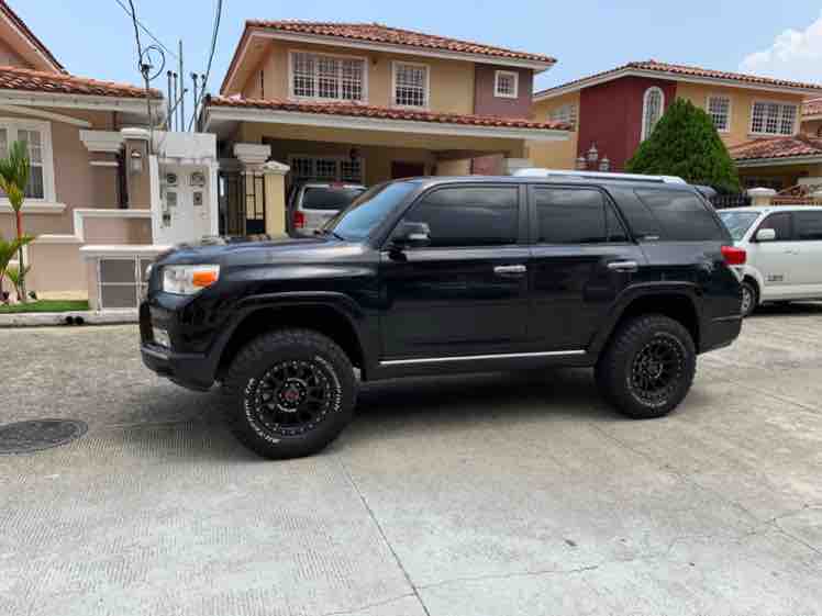

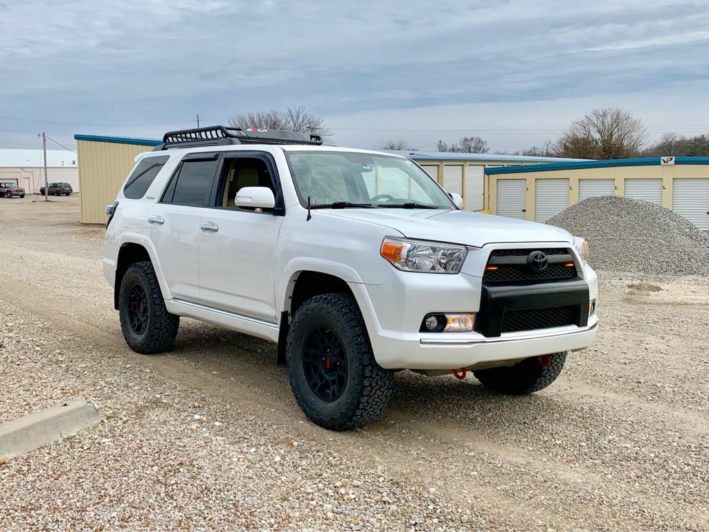

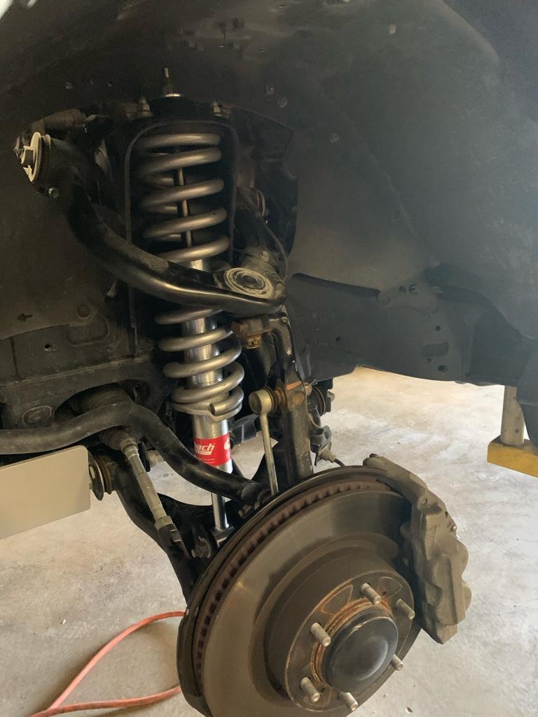

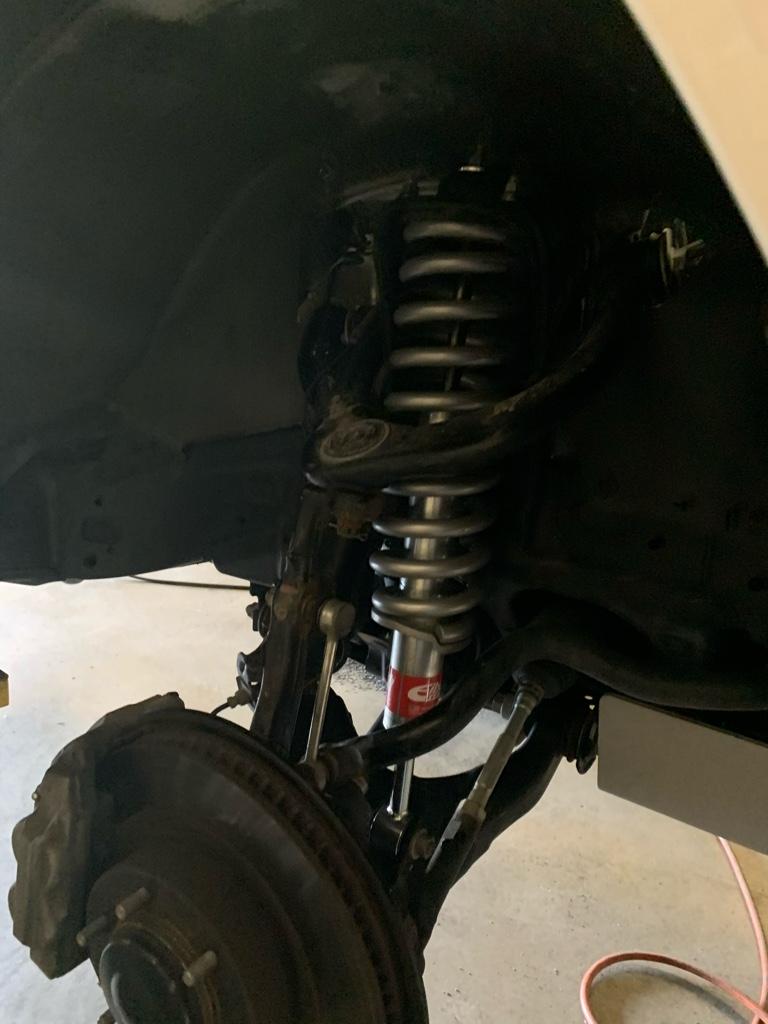

Well this is my 4runner, eibach shocks and coils in front at the second clip, drivers front side with 1/2 top plate. In the rear ome 2889 coils with eibach shocks. The trucks feels awesome. Tires bfg ko2 285/70 with 17x8.5 wheels with 1.25 spacers.
