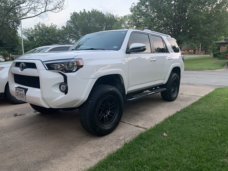

I just had a local dealer here in DFW install the Eibach kit along with some SPC upper control arms. I had tire rub before, but with my caster now sitting at about 4.7 the rub is gone (running 275/65 right now). Overall, I am thrilled with the kit and highly recommend it. It just soaks up all of the road imperfections like it's nothing now. Very composed and it handles on rails in the corners. Here are some before and after pics. I had a Revtek front spacer kit before the Eibach kit. I should have just done the Eibach kit to begin with!
Before:
After:
Do you get any rubbing with the 285/70r17 tires? Or did you have to do some modifications to make them work? I am getting a Eibach installed and I am debating on 275's or 285's. Thanks.
If you are going to be running either of those tire sizes, I highly recommend installing adjustable upper control arms when you have the Eibach kit installed. I would probably still be rubbing if it weren't for the control arms and the caster we were able to achieve with them.
Correct me if I’m wrong, but your wheel offset is going to be an important variable here. I had an aggressive offset (don’t remember what it is unfortunately) and I rubbed with 275s on 17x9s and needed the bmc.

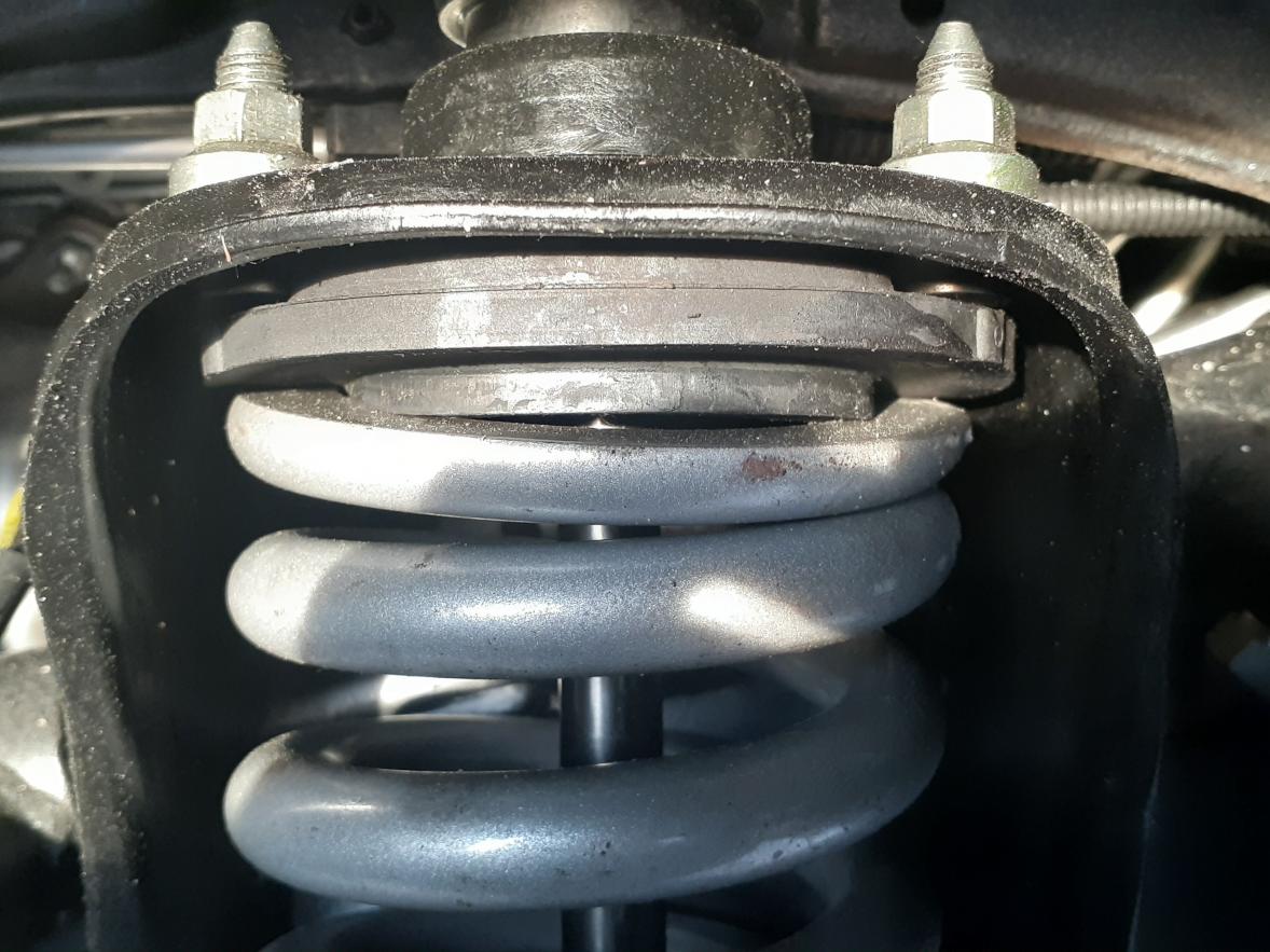

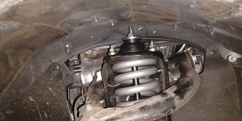

Guys, I have about 300 miles on my pro leveling kit and just noticed this. Seems like the spring is not seated properly or I am over thinking it. Yours looks like this?
Nope, might need to re-seat that.

I am still on the Eibach Stage 1 Pro Truck Kit. Still comfortable, and still dollar for dollar all smiles. I did add air bags to the rear for when tow duty calls.
I changed my setup from TRD Pro wheels on KO2 265/70/17 with 1.25" Spider Trax Spacers to Titan7 AK1’s with Falken AT3W 285/70/17 spacer free and it still rides like a dream.
No rubbing issues at full lock compressed or uncompressed. (Wheel specs 17x8.5 -8, front liner pushed forward with bumper trimmed, front mud flaps removed, and rear flaps are about to go bye bye)

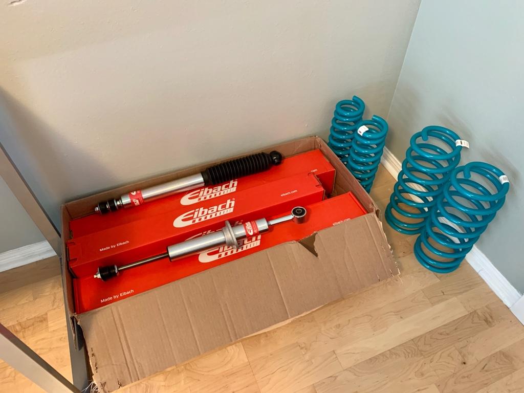

Why did you decide to go with Dobinson coils and Eibach shocks? Why not Dobinson shocks as well or a different brand?
I wanted the Eibach shocks because they had really good reviews on this forum and were monotubes but I also wanted more lift in the rear and Dobinsons had a lot of options to go with. Oh and I also wanted a lower spring rate. It also helped that I was able to buy a cheap non used set from a member on the FJ forum. The whole kit together cost me $745 shipped. I will post a review of the combo today or tomorrow.
what springs did you go with? I am debating doing the same thing. I have KDSS and wanted to do the Dobinsons spring b/c they make KDSS specific ones with different heights to help prevent the KDSS lean, hopefully without needing spacers. Also wanting more of a rake in the back and going with their 1.25-1.5 inch springs. That way if I tow or something it wont sag below the front height
