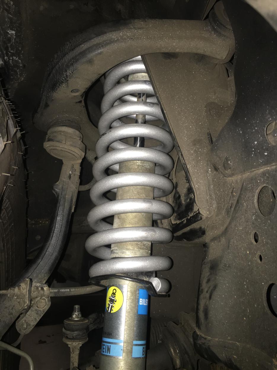

Just installed a pair of eibach coils. After install I noticed that the passenger coil had some what of a bend/curve to it. So I removed the entire assembly and disassembled to check for and misalignment. I then rotated everything 180deg. And re-installed but the bend still seems to be there (bend followed the rotated spring). Is this somewhat normal? I'm running the tundra billies on the 1st perch. Everything appears to be seated/centered and assembled correctly.
I've contacted toytec about the issue as well, but I'm afraid I'll get the run around. Anyone else experience this?

"These springs look alright to me to be used. They will be compressed onto the shock and will work with no issues. No coil will be 100% straight. This will not affect anything.

Maybe its just stupid paranoia but what bothered me about them was that by not being centered on the strut that they might cause stanchion wear and premature failure of the shock.

The bowing of the coil doesnt look too drastic to me. That is not poor quality control as we did not sell a tundra bilstein for the 3rd gen 4runner assembled. That is pre-load and it will settle after some time. You are using Tundra Bilsteins on a 3rd gen 4Runner which we do not recommend here. We have 5100's specifically for your truck.

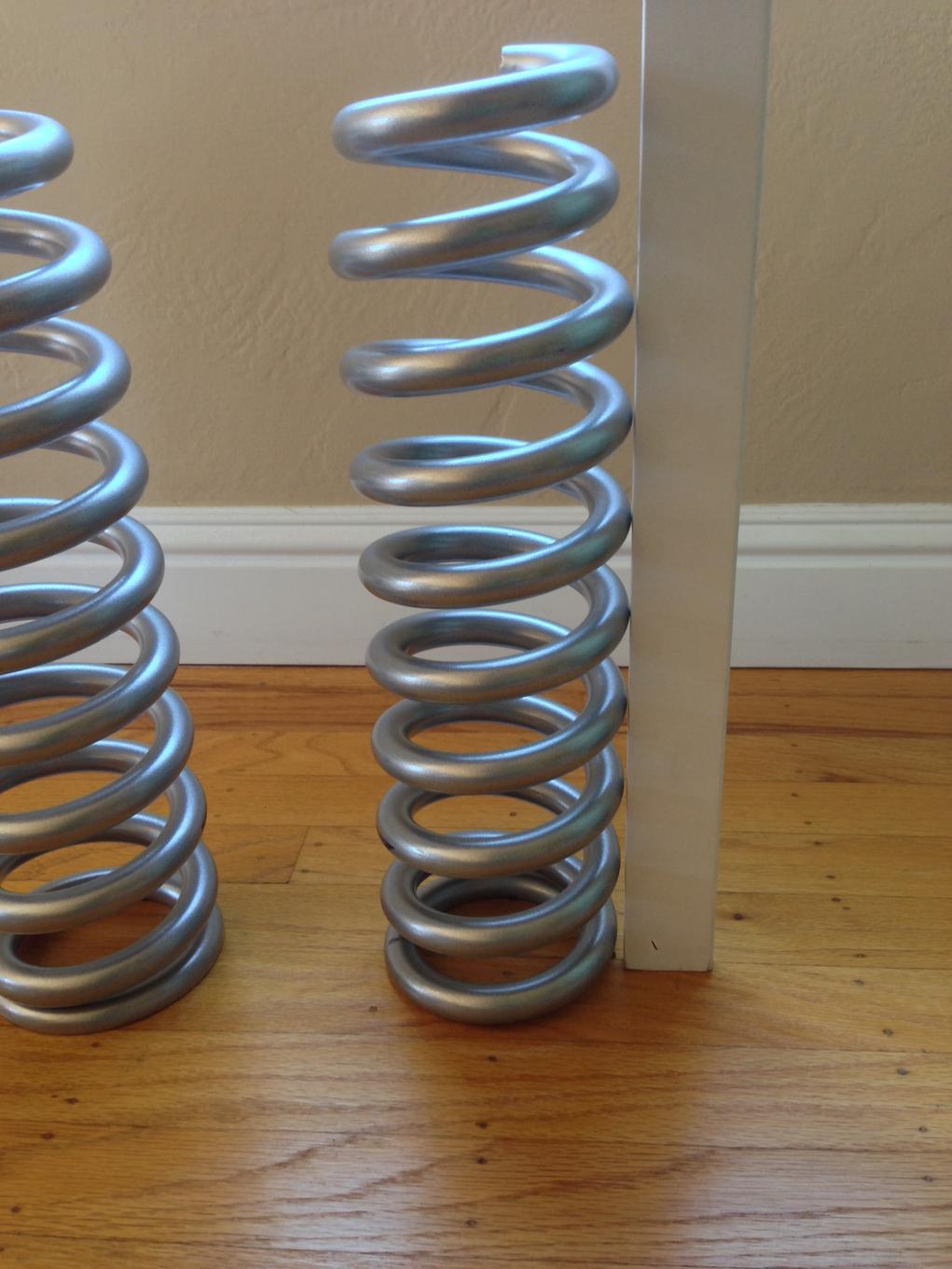

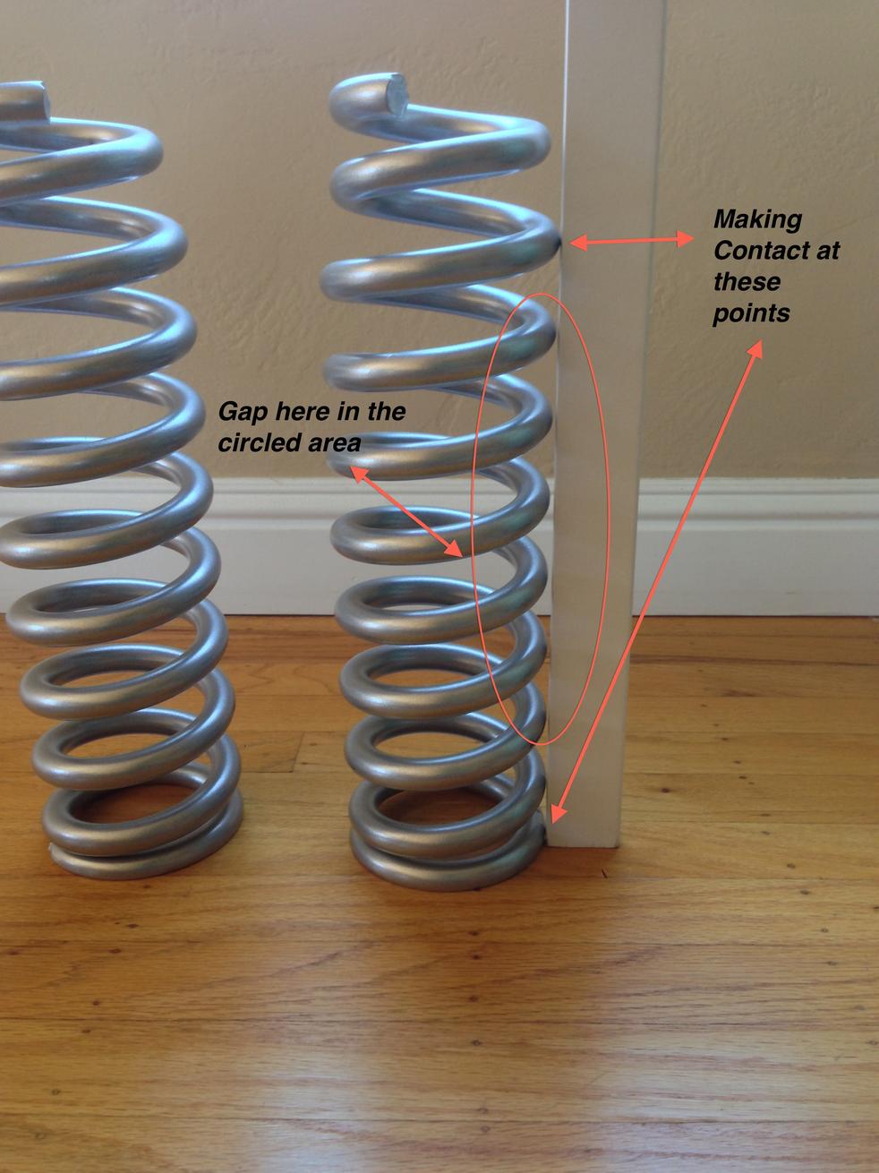

Just to clarify the bowing of these springs has nothing at all to do with the shock they are being used on. They are bowed out of the box, if anything on the Tundra shock there is less preload on these springs so they should bow less than on Tacoma 5100's.
That having been established, the springs when new out of the box placed on a flat surface have about a +/- 1/4inch variation from the middle to the top and bottom.
Again, I am not an engineer or an expert of any kind. This variation could be normal and perfectly fine.
I have installed other sets earlier production runs of the Toytec Eibach springs on Tacoma's and 4Runners and they did not have any bend in them. I have installed a few sets of OME springs and never noticed this with OME springs. I have also installed struts and springs on other vehicles I have owned, mostly sports cars and never seen a spring with a bend in it. Given that this wasn't my first time purchasing or installing these eibach/toytec springs but rather my third time buying them and installing them, I was surprised to see the difference.

The reason we dont recommend the Tundra Bilstiens for the 4runner is not because they wont fit but the fact that we have seen many people over lift and in turn over extend the shocks. The 4Runner and Tacoma are different yes, but they have the same platform and tend to be around the same weight overall.
Regarding the spring, as stated before some of them do have a slightl bend in them.
