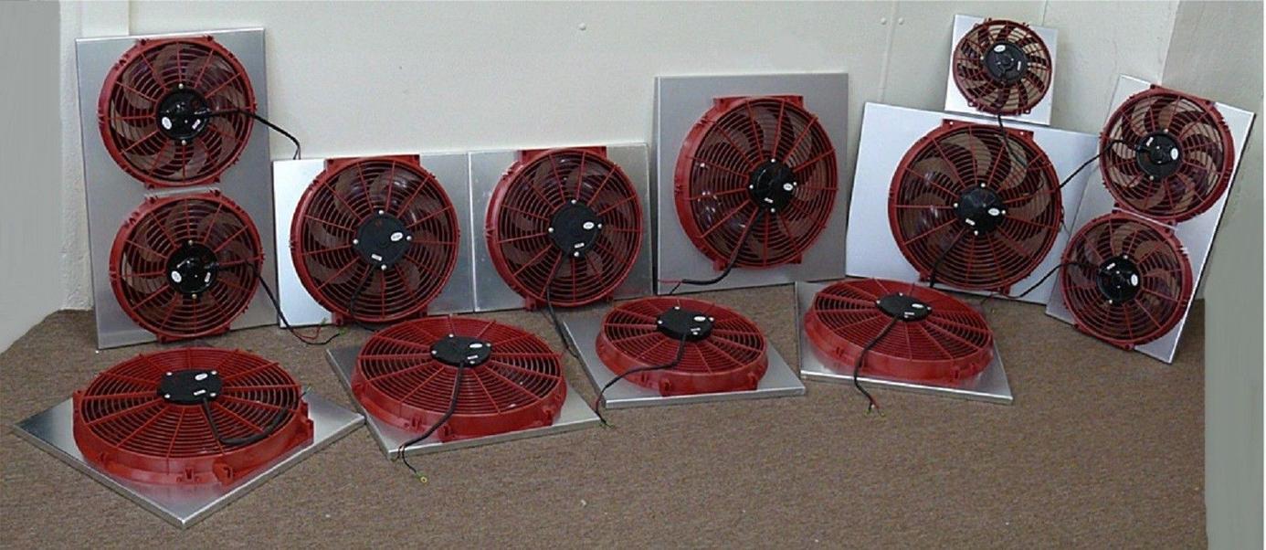

Now, I do know this has been asked many many times, about e-fan conversions. Thing is no one really has a decisive answer. I used the 3rd gen specific thread search and sifted through everything I could find. There's flex-lite kits that get praised and trashed right and left, but it's enough so that I've just decided to stay away. There's a similar Jegs universal kit which is not ideal but hopefully the quality isn't as bad. There's also the Taurus e-fan mod that I couldn't find a decent write up here on, but did sound mildly promising. Then I stumbled upon this while looking through:
Toyota 4Runner Electric Cooling Fan Kit More MPG HP | eBay
Its a company called FF dynamics who seem to make quality fan shrouds and kits for many different vehicles and have 3rd gen specific kit on ebay (link above^) but not listed on their website. They also have an "extreme duty" section that does not have a Toyota listed but most of the sections do say something along the lines of if you have an high performance vehicle ask about our extreme fan setups. I've messaged the seller be they haven't gotten back to me.
If anyone has any good experience with our runners they'd like to share it would be much appreciated. Also I haven't looked into their fan and electronics source yet. But here's the pic they advertise for reference, I do not know if any of those are the runner kits.

OP, the fans pictured are re-labled SPAL fans. I used to sell them in 24V versions for marine applications. Most of them are made in Italy as far as I know (haven't dealt with them directly in a couple of years) They're good quality fans.

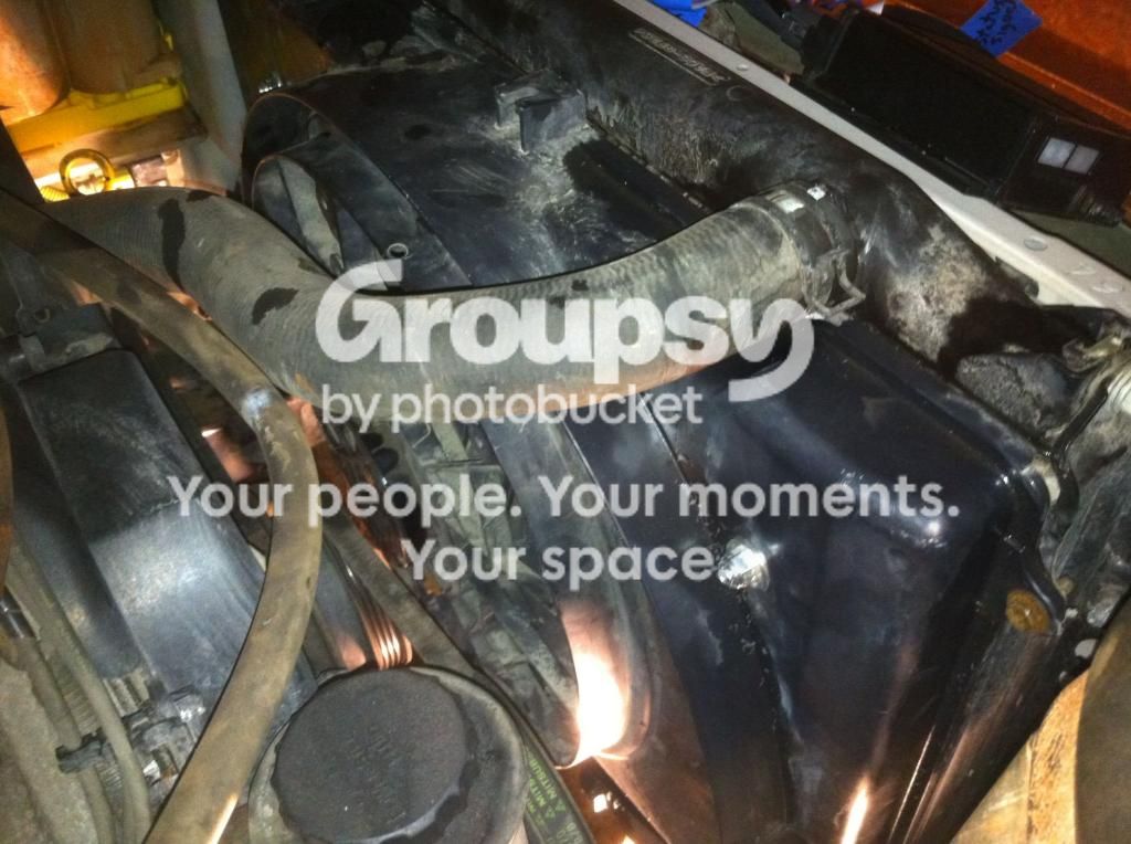

I'm interested in the heating the shroud and wiring part. I can do any kind of heating a reforming but I'm sub-par at wiring.

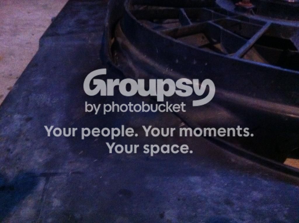

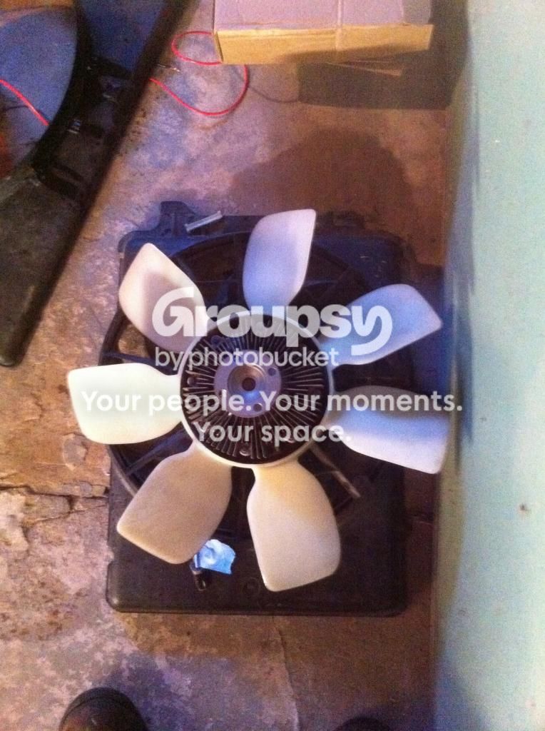

Here is what I had for pictures when I did it. When I held them together, the taurus fan fit right in the stock fan hole. I lined it up so the top two places I bolted it were flat and bolted it together. The bottom two holes as shown below involved simply heating the stock shroud until I could push the taurus fan into it so it would sit flat against the radiator.
As for the wiring, I wired the SPAL controller based on it's manual connected to the low fan wires. Then for the high, I used a toggle switch with two relays to completely disconnect the SPAL ground/positive from the fan and then the toggle switch completes the fan circuit. The reason for this was a complication with having the high and low circuits both connected and no two speed controllers out there.
Fan size comparison

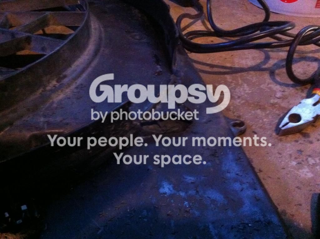

Taurus fan behind stock shroud. Notched the edge where I was going to heat it on the part of the shroud that has a deeper lip.
Formed to fit the fan
Installed
