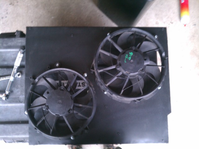

You can see my full set up in my build thread (sig) around page one or two. I've had zero issues with minep since I completed it. I have heard a lot of people having problems but these seem to be the same people that try to run under powered fans from the junk yard, or ones that try to tie wrap cheap auto parts store crap to the radiator with out a proper shroud.
My advice to people is if they are looking for a cheap upgrade this probably isn't it. If they are willing to spend some money on some decent fans (Spal would be my first choice) and build a proper shroud, then its a great upgrade.

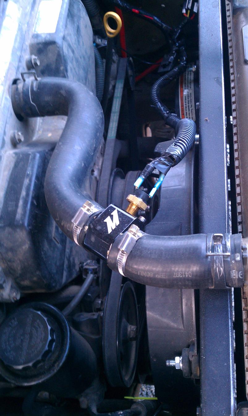

But for the record, I think the most important part is the controller. You can't go cheap on it. It needs to be the one that reads the coolant. Not the push in probe type, those things are crap. They read airflow and reading off the fins isn't very accurate. The temp sensor has to be touching the liquid coolant to get an accurate read.

For others here is mine.
2 fans out of a 98 taurus and a derale sensor with inline adapter.
