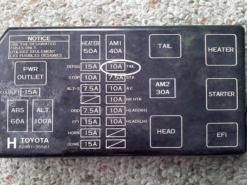

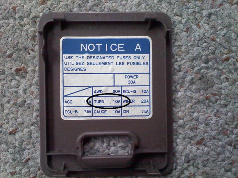

The two fuses that keep blowing are the 10A "turn" in the cabin fuse box, and the 10A "tail" fuse in the engine bay.

So I am getting desperate here. Just for clarification these are the fuses I keep blowing
EDIT: The fuses blow when I turn the left signal, not the right. The issue has involved the lift side from the beggining.
