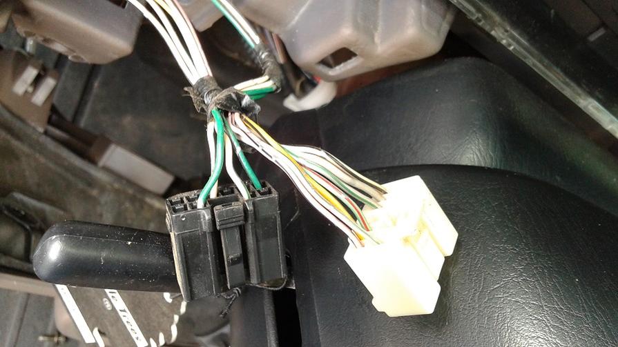

Ok, so I looked behind the kick panel and I'm fairly certain mine is not prewired for the locker. No ECU box, no gaggle of green wires on any plug that I could see... I found a couple of plugs behind the dash but not sure if either is for a RR locker switch. Can anyone tell me what these are for? Thanks.
They are not for the elocker switch what are u looking for is a black plug with two wires and the colors are black/yellow and green/yellow, and the elocker ecm has 10 wires on the lower driver side under dash by the right kick panel. Lucky me on my 99 it came pre-wired for the elocker.
