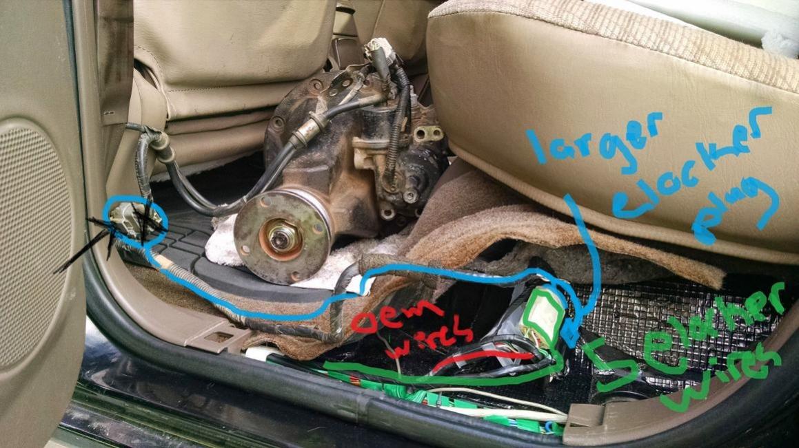

Please, please, PLEASE don't be mad for resurrecting an old thread, I don't have the post count to create a new thread!
I'm using Wikano's picture for connector identification; I hope that's okay with Wikano, if not, I'll happliy pull it down.
I've put an arrow for the connector side I'm after and an X through the side not needed (as it's part of the locker harness). The connector I'm after is the one the axle locker harness plugs into at the frame and has the locking push tab. If I can get the part number, and maybe the pins, that would be greatly appreciated!
Thank you T4R.org in advance!
