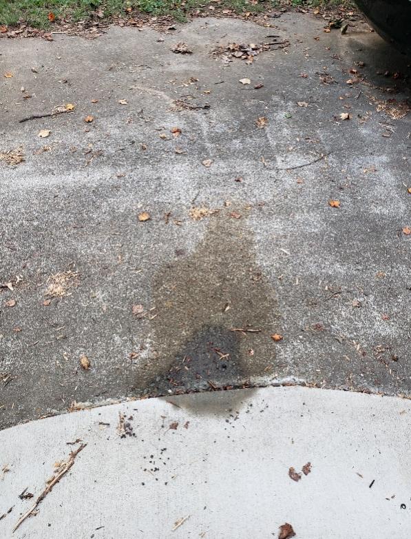

I just drove my 2006 V8 to a corner store at the end of the block, 300 yards max. Everything was fine, as always. Then when I got back into the truck to go home, I noticed that the red E-brake light was on (not engaged though), also the orange VSC/trac lights. Then it began making a howling continuous alarm beep. Then about 100 yards into the trip I noticed the regular foot brakes DON'T WORK. I have no braking. Luckily the 300 yard trip back to my house is *slightly* uphill. I just gave it weak gas and crawled home, then let gravity stop at the curb in front of my house.
Help!?
I'll ask the obvious, any sign of brake fluid leakage? How does fluid level in reservoir look?
Oh sh-t. Yeah I would say this is some evidence. Good call. This is the driveway spot it was in until my recent drive.

And yeah the brake fluid reservoir is empty. WTF
You have a leak in your (hydraulic) braking system. Easiest way to find it is to look for wet spots on the truck above where that puddle is. If you've never worked on a brake system yourself, have it towed to somebody you trust. Do not drive it.

Find and fix the leak, refill the master cylinder and then bleed the brakes.

Check the hard lines at each front caliper, then check the lines on the left side above the rear diff.. then spread out from there..

So yeah, rusted brake line
It took me a week of it sitting before I got around to towing it to a Toyota/Lexus shop. Then it spent almost 4 weeks there waiting on the backordered brake line. I've now got it back fixed. Thanks everyone.
