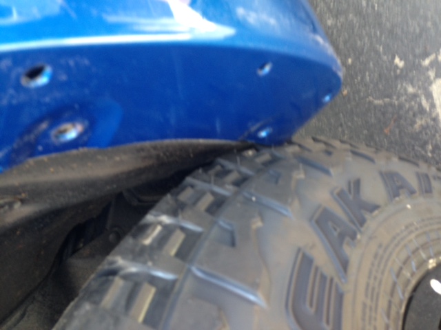

Over the past month, I have had new exterior paint color change, new leather installed, new Bilstein 5100 at 2.5" front, 2" rear Daystars and new 17" -12mm offset wheels with Falken Wildpeak AT3Ws put n (that was today). Everything took waayyyy longer than it was supposed to. I have not had my T4R for the last 4 weeks.
Well, later today, when I was supposed to FINALLY pick it up, the shop calls me and tells me that the front tire rubs on the rear part of the fender well where the body seam is rubbing badly.

Doesn't sound like you did enough research first, that being said, be glad to give advice!
Did the shop remove the mud flaps? Probably not! Ask them, if they haven't, do that and see where you are!
If that doesn't do it, you may need to do a Body mount chop, Body mount chop - Toyota 120 Platforms Forum
You may have an issue with -12 offset wheels!
My bet, just remove the mud flaps, you may have to do a little trimming, also ask them if they have aligned it yet.
I agree, but I have this feeling especially since a "shop" is doing it, the flaps are rubbing!

Thanks for the advice! They did remove the mud flap, but nothing on the "rear fender liner" area (don't know if I am calling it the right thing. I think, after reading this and looking up the body mount chop, that that is what it is.
I don't have access to a welder, so do you think a 1" BL would fix the issue? I can get a BL here in 24 hours and have them put it in.

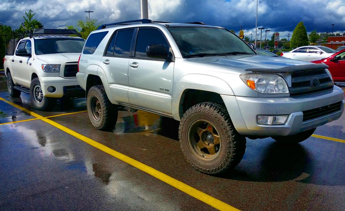

Why not go with a 255 80 17, which is even taller than a 285 70 17? It's what I've got,.. on a negative 11 offset wheel and have no rubbing issues at all.
Here's a shot when I first got them.,,

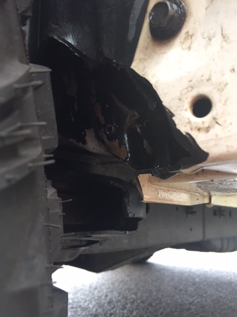

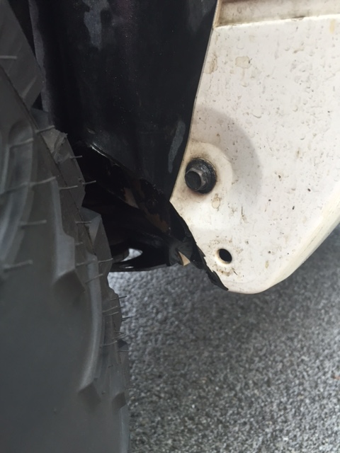

Body lift will do nothing at all, body mount and tire will all be in the same place! Have they done alignment? Sounds like you need a chop!
You don't have to weld the piece on, if you don't cut it too close to body bushing. I cut mine 4 years ago and haven't welded a piece there, many others have done the same.
See my above post to solve all your issues.
Taller tire than you've got now, and no rubbing.
Win win.

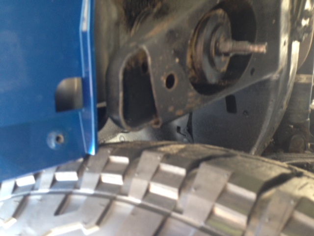

Sparky, I think I am going to take your tip and run with it. It seemed daunting at first, but now after reading it and seeing pics, it does not look bad at all.
Only question: What is between the tire and the body mount? It looks like a metal inside of the fender or something from what I remember. Here is a pic from yesterday. I am going to the shop in about 2 hours once my ride gets here.IMG_0102.JPG

With an alignment try getting the max caster allowed within factory spec and that could help you avoid the rubbing and down sizing. Even though it doesn't seem like your rubbing on the BM, the following thread explains it.
Eliminate Rub w/o BMC
[MENTION=133792]Atlas415[/MENTION] search Pinch weld, you can hammer it down or cut it down and that will help with an inch or so of space. Trim the plastic and hammer the pinch weld down. Should be ok.
Win win.

I have said it a few times, when it's warranted, and people ask for suggestions. I don't spam threads talking about it, only when a relevant question is asked, do I offer my auggestions, which I feel to be the best answer. Just like you did regarding cutting your body mount. We are all on the same team here man.. trying to give this guy some advice on how to fix his truck.

We had to do the body mount chop to get our 35's to fit, and that was after 7" of lift. She's all happy now!
