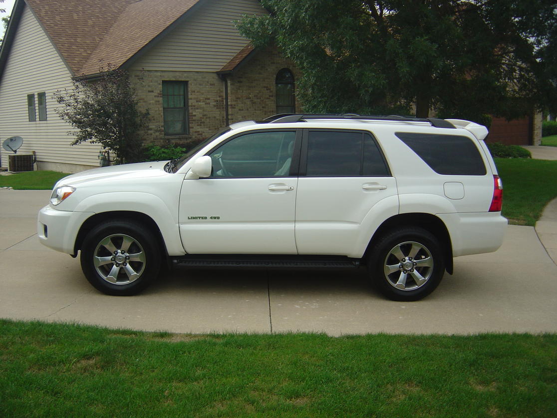

It's a 2008 Limited with the V6 engine. Right at 120,000 miles.
