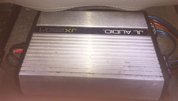

1. I checked the ground wire on the sub amp and made sure it's touching bare metal. The guy who installed it just used a single black screw through the paint. I ground it down to metal and used a ring crimper on the end of the ground wire.

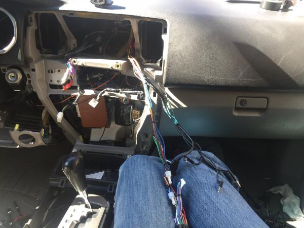

2. Wiring behind the head unit. There was a jungle of wires in there from a previous "pro" installer. I took everything out and made it as clean as I could. I ADDED a ground wire from the engine compartment to the head unit, but I didn't REMOVE the original ground wire.

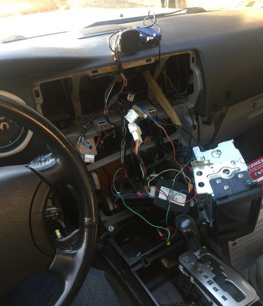

To connect the Pioneet head unit to the oem JBL amp I used a Metra TYTO-01 JBL Amplifier Interface Harness. I tried my best to correct the rats nest of wires that the "pro" installer had in the dash from my previous head unit upgrade. They didn't use any connectors at all, just pigtail twisted the wires and electrical taped it together. After removing all the gunk from the melted tape glue, trimming the wires, I then used crimp connectors (I don't own a portable torch and I don't have a garage) and cleaned up the wires as best I could.
Before:
After:

I confirmed the bzzzz noise is ONLY coming from the right front tweeter (it's a coaxial speaker). Maybe the speaker is touching a part of the metal mounting bracket and grounding itself somehow?
If I can't fix this buzzing by inspecting that tweeter and perhaps jiggling the wires like I'm The Fonz, my next step will be to buy a new amp and run new wire to all speakers.
