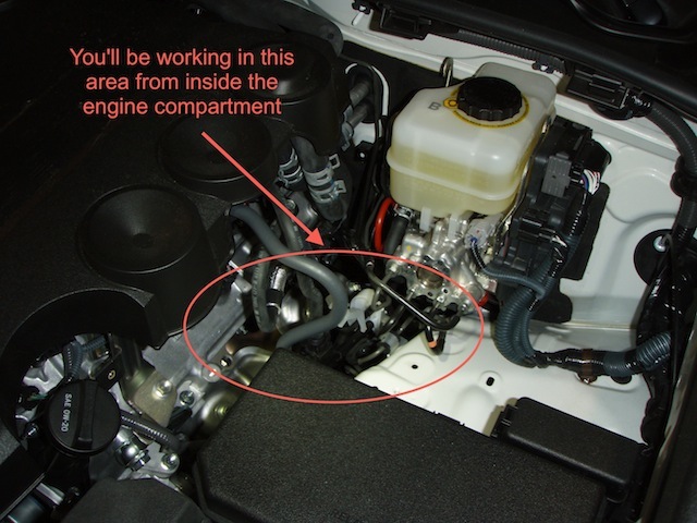

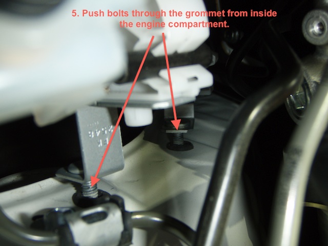

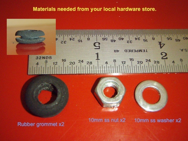

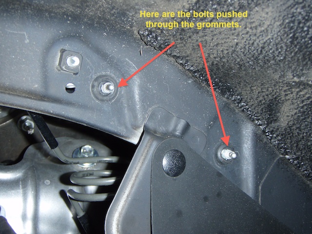

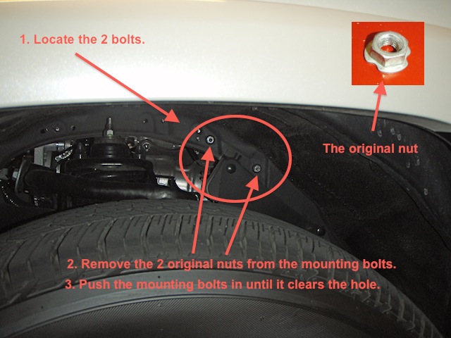

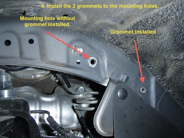

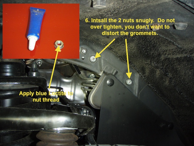

My previous 2006 4Runner also had the drumming noise at idle. I was disappointed that the new 2010 4Runner did the same thing, but since I knew the source of the noise I went ahead and fixed it on the new 4Runner. The noise is generated by the pulsating fuel line which then transmits pulses to the driver side wheel well and for some reason it would resonate the pulses as a drumming noise into driver side cabin area. There are 2 brackets that hold the fuel line to the wheel well that are easily accessible through the driver side wheel well opening. What I did was isolate the mounting bolt with rubber grommets that are readily available at the Home Depot. I'll get some pictures up when I get a chance and also put up some kind of write up.
it would be nice to put up pics. had a chance yet?
Here you go. Like I said previously this repair has worked on both my 2006 and 2010 4Runner to the point where the noise is minimal and subjectively acceptable to myself. Also, I will not be monitoring this thread since I am real busy. And, for the critic in this thread I do not have the liberty to disclose my occupation, so lets leave that there.
Disclaimer - I hold no responsibility for any damage that you may incur performing this repair. Nor will I be responsible if you are not satisfied with the outcome of this repair.

dcon
excellent pictures and write-up
This looks like an easy fix. Others should try it and see if it fixes their noise.
dcon
Thanks. I'm not sure if the noise exists on the V8 4Runners, so this fix may only apply to V6 owners.

Did the Modification but it did not help. I took it to the dealer and I test drove the truck with the mechanic. He heard the noise and then we went back to the dealership so he could look at it while I wait inside.After about 15 min. he came back to me and he said he started up 2 4Runners out back and they both did it so according to them it's normal of course.
