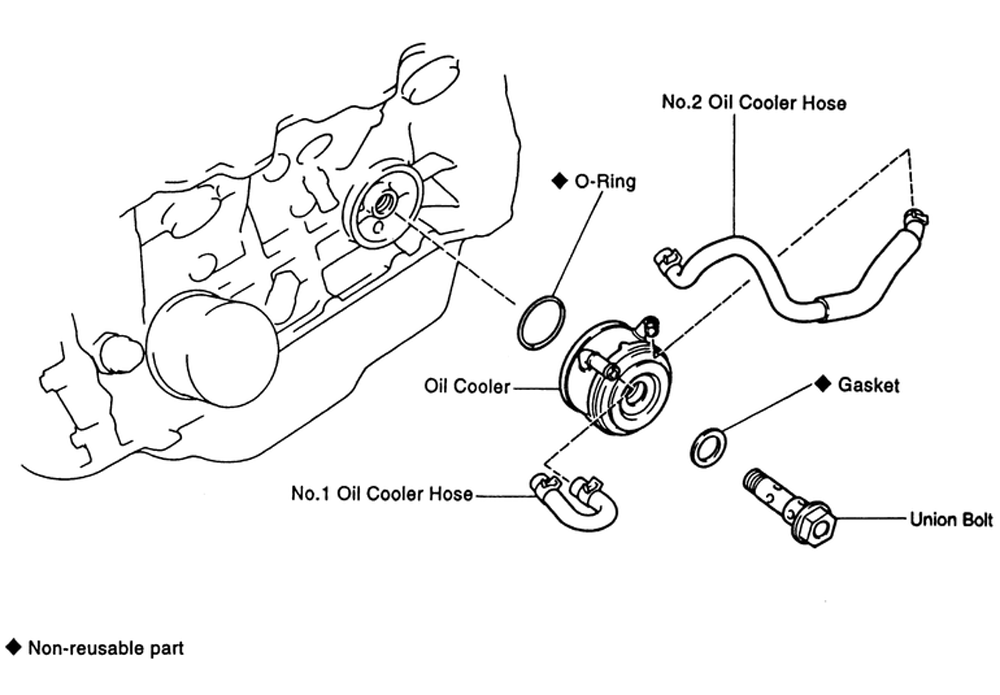

I have yet to see a 5VZ-FE that didn't have an engine oil cooler from the factory.
I guess it is possible that some were produced without the engine oil cooler, but I would bet that you have the factory engine oil cooler too.
