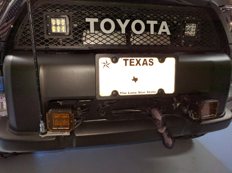

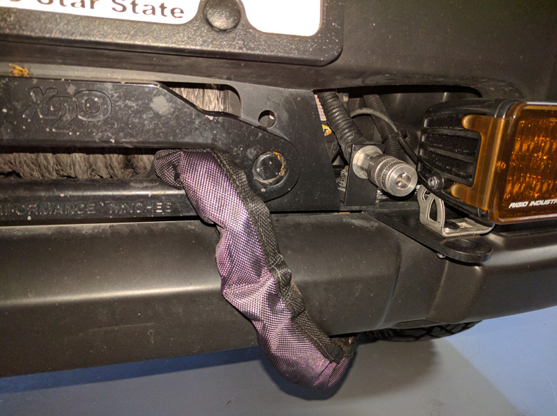

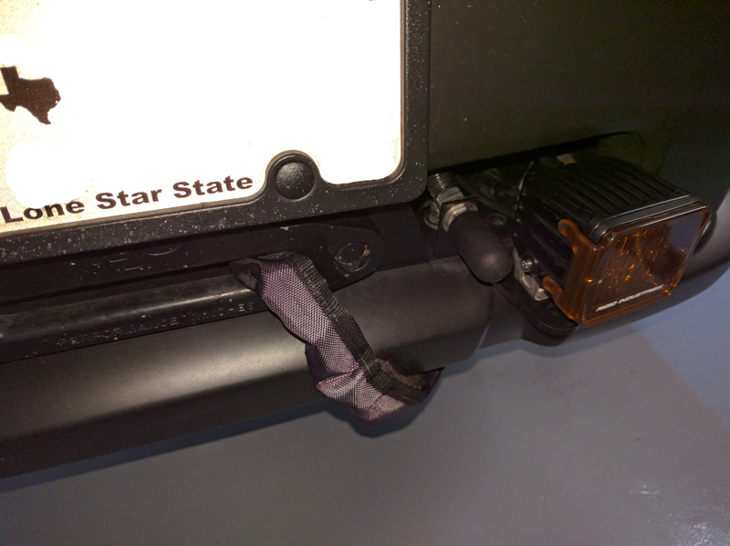

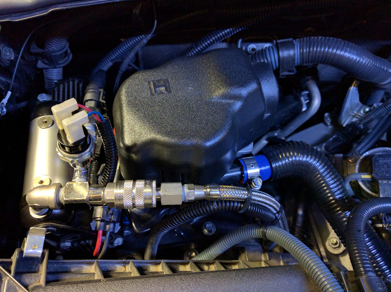

...I decided to run a stainless hose to the front of the truck and mount a quick disconnect. No more hood, no more gloves. I aired up my 285s from 16 to 38 psi in about 5-7 minutes in the 100+°F heat and the compressor didn't hit thermal cutoff ...
I also added some Rigid DOT approved fog lights which work well but are not very bright compared to the D2 (no big surprise there).
The rubber cap fits snugly and just pulls off when you are ready to access the quick disconnect. I haven't tried fording water/muck to see if the fitting gets gunked up but worst case, I can still quick disconnect it at the pump.
Can you tell me where you got this much stainless air line? Where from? How long is it? and a fittings list would be helpful if possible. I am about to reroute my air source for the same reasons you have here (heat, burn yourself, ease of access, etc.) and i am curious about where you got this air line. I am having a hard time finding hoses longer than 22"...
McMaster-Carr
5680K61 72" Hose (316 is adequate, 321 in theory offers better corrosion at high temps but is overkill for this application)
Some of the fittings:
6718K84
6718K26
6718K52
I also used some tee fittings, right angles, etc. Just come up with a plan that meets your needs and browse McMaster.
In general, I recommend stainless if you have the budget. 321>316>304 concerning corrosion due to higher chromium content. 304 is generally adequate but sometimes I splurge.
Also, you'll want to figure out a "port" or bracket to present your coupling. Mine was just a piece of aluminum angle with some holes drilled in it for the coupling and mounting.
Bonus: Here's the rubber cap that fits the coupling just right →6448K34
PM me know if you'd like additional help.

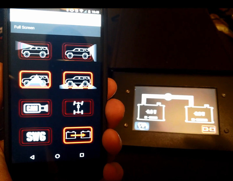

Here is a proof of concept showing some of the platform capabilities of the Overland Computer.
Problem: I'm in my roof top tent and I want to turn on or off some lights without having to climb down into the cabin.
Overly complicated solution:
Basically, the sbRIO system running LabVIEW RT can also host a web service to interact with the data running on the application. Since the web service can host html, java script, style sheets, bootstraps, images, etc., all you need is an internet browser and a shared wi-fi connection to get and put from the application. A friend of mine at work did the heavy lifting to develop some java script that I could adapt to my needs. I wanted a button press on the mobile browser to not only turn on that particular digital output (controlling the relay), but also for that new state to be reflected on the Amulet display panel mounted in the cabin. Also, I wanted a button press inside the cabin to show up on the mobile device. This turned out to be harder than I thought when implementing into the state machine running on the computer but I hacked it together and it seems to work now.
I think this solution isn't practical for real deployment so I probably won't set it up in the truck. It would work better if it was just a simple bluetooth connection running from an android app but that requires me to actually know how to program stuff. However, it demonstrates the capabilities. I'd like to be able to log in to my overland computer remotely from anywhere in the world so now my research is heading toward mobile modems and GPRS like stuff.
Anyway, here's a simple demonstration of the system in action:

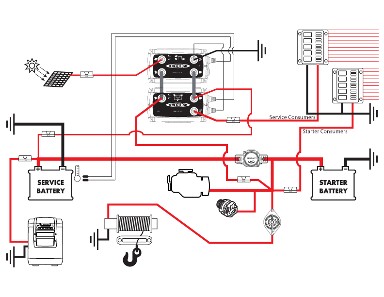

Here’s the controversial piece. I’m not a battery expert by any means so I tried to educate myself on proper charging fundamentals for a deep cycle (substantial discharge) auxiliary battery. I did an exhaustive search and found many great products out there. There are many systems that automatically detect when the engine is on (alternator is putting out) and then link the two batteries to allow the consumer battery to draw from the alternator. I researched the particular voltage thresholds for these types of systems and made my own linking setup using a high current relay and a real time controller. After more research, however, I found that charging a deeply discharged battery from just the voltage level that an alternator puts out does not fully recharge it and can lead to decreased life expectancy. The higher end chargers ramp up the voltage and ramp down the current in a particular fashion to maximize the acceptance of the charge as well as maintain a proper floating charge when full. Some can even automatically detect sulfated batteries and pulse the voltage and current to de-crystallize a battery. I wanted a system that could power my consumers from the alternator while driving such that the auxiliary battery could properly charge at the needed voltages without those higher voltages affecting my consumers. Oh yeah, I also thought it would be neat to have a solar panel input with automatic Maximum Power Point Tracking capabilities so my consumers could run and batteries charge from solar power. But I still wanted to be able to link my two batteries in case a) I needed to jump start myself or b) during winching to reduce the strain on the primary battery and alternator. So does such a system exist? No. But the closest I could find is made by battery charging experts C-TEK. The D250S DUAL and the SMARTPASS combine to provide all the features listed above (except high current linking for jump starting). The SMARTPASS gives up to 80A from either the starter or consumer batteries to power the consumers depending on which battery is charging and the D250S handles the charging and provides up to 20A from solar panel input. The system is pretty incredible and though a little pricey, it is packed with excellent overlanding features. The Achilles heel of the system, however, is that the electronics are rated to only -20°C to +50°C (-4°F to +122°F) and the enclosure is only IP 65. I don’t have perfect solutions to those problems but I’ll later discuss my mitigations and contingencies.
High Current Relay for Linking-
It’s later. I selected a high current relay from Gigavac. The MX12 series is IP 69K, temperature rated from -55°C to 100°C and can do 800A for 10 seconds (jump starting) , and 200A continuously (sharing the load while winching or powering the engine entirely if the primary battery has failed). If my charging system has failed, then I can still link the two batteries using this relay and allow the alternator to charge the auxiliary battery.
Step 3: Make a plan

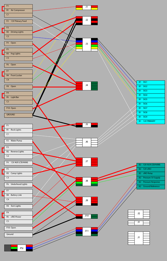

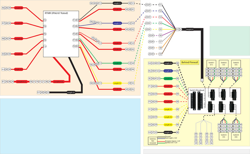

Going down the custom road takes more effort but the results can be closer to the desired goals. Here is a basic depiction of the wiring plan.
An initial draft of my schematic showing the use of one RTMR powered by the primary battery.
A later wiring diagram showing both RTMR connections and the necessary bundles of cables going to quick disconnects.
