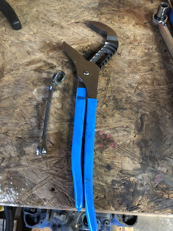

You guys that have been working on these trucks for a while may already know this, but for a beginner like me I was a bit concerned about removing the rear shocks after reading all the horror stories here. So after watching a Timmy video installing rear Bilsteins with a flexible ratchet wrench it got me thinking. Since the top housing is attached to the upper stud, I should be able to attach said wrench to top nut, lodge it against the frame and turn the shock body. So with that and a set of 16” Channel T&G pliers I did just that. I had both factory shocks off in less than 20 minutes. The right shock actually sheared the stud after about four turns of the shock body. I left the bottom bolt installed during this method.
Anyway, maybe that will help someone who in the future.

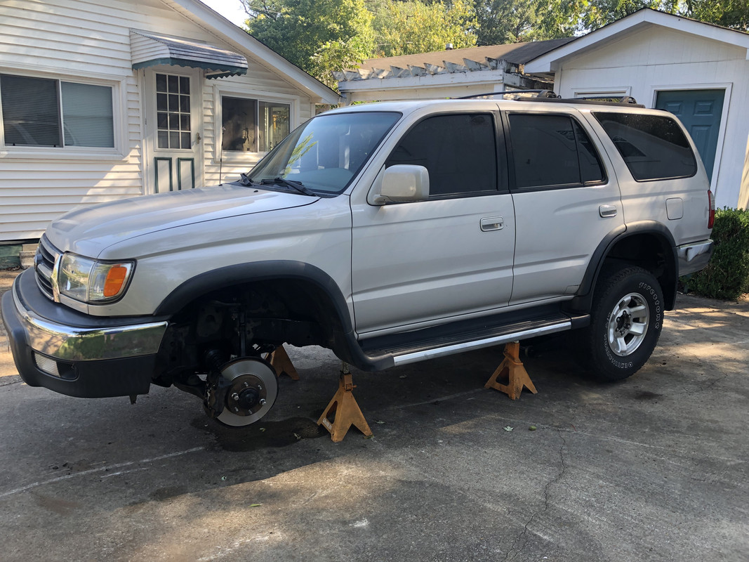

Getting Close!
Waiting on front coil springs. I somehow left those out of the basket when I ordered all the other items. Didn’t realize it until everything else showed up Thursday.
Success!
Strut bushings showed up at 10AM today. Finished it at 2PM. Had it in the alignment shop at 2:30PM. Wow what a difference new suspension makes. It rides and drives so much better...almost like new I would assume. I love Bilstein shocks. I use them on my race car as well.
