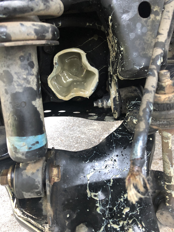

So this happened about an hour ago to my ‘99 4WD. Fortunately, I was on a downtown street only going 25-30MPH. No traffic. Lost all brakes and steering...duh!
So what am I looking at here, upper and lower ball joints? Looks like brake line also. Looks like the shocks are also fairly old.

Yup UBJ, LBJ, Brake line, CV Joint. Probably new axle seal I can't tell if the sway bar is still connected or not. Would check the make sure rotor not bend and the brake caliper aright.

What’s weird is the the road I was traveling was as flat as could be. No bumps. No dips. It just snapped.
The flat bed driver said in his many years of service (and he was old) he had never seen one single Toyota fail in this manner. Leave it to me...
Alignment is less than a year old. I did notice last week that return to center seemed way less than normal. I assumed caster had somehow been decreased. Maybe that was a red flag to this.

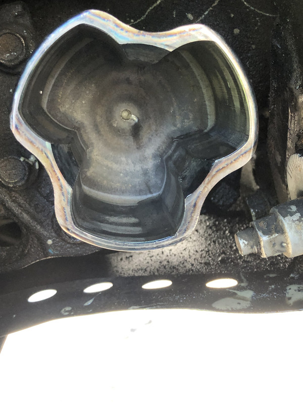

Is CV joint lube supposed to look like this? Does this look hurt or can I clean it and reassemble? I have a parts washer.

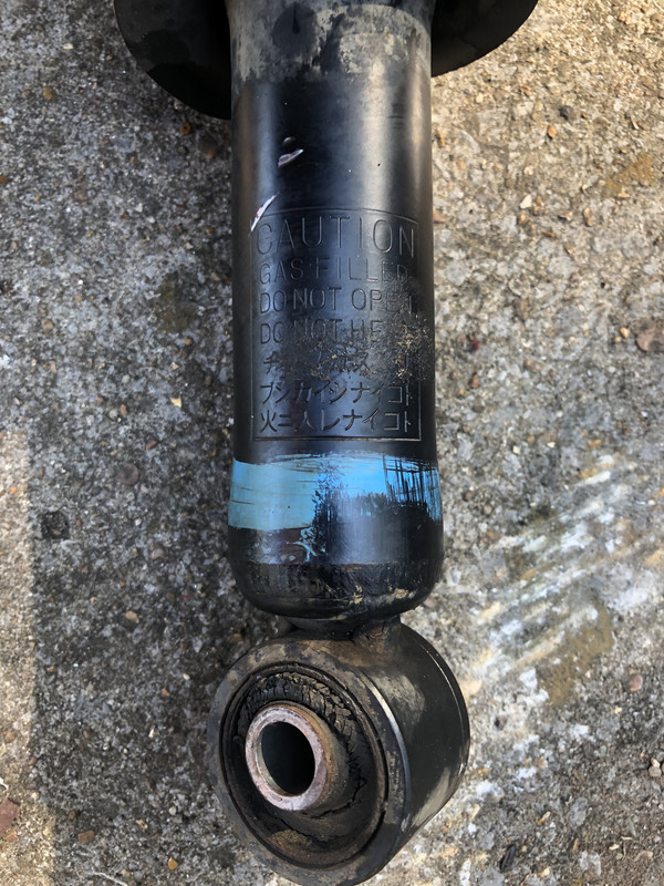

I’m guessing OEM struts and springs...Japanese Kettering and what appears to be factory paint markings. I guess that’s why it was a bit wobbly at 70MPH.
