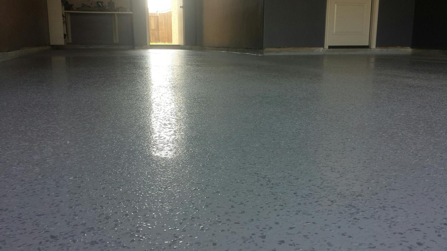

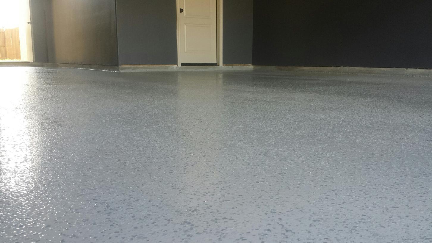

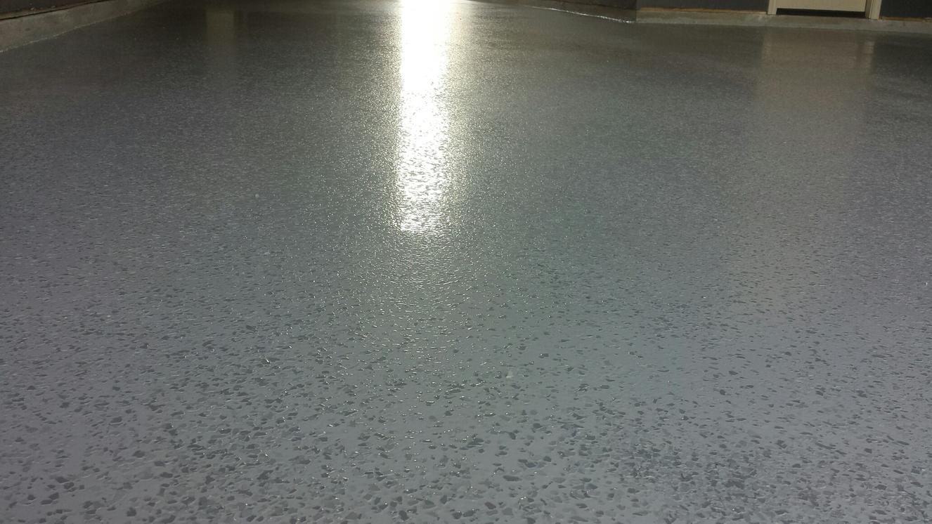

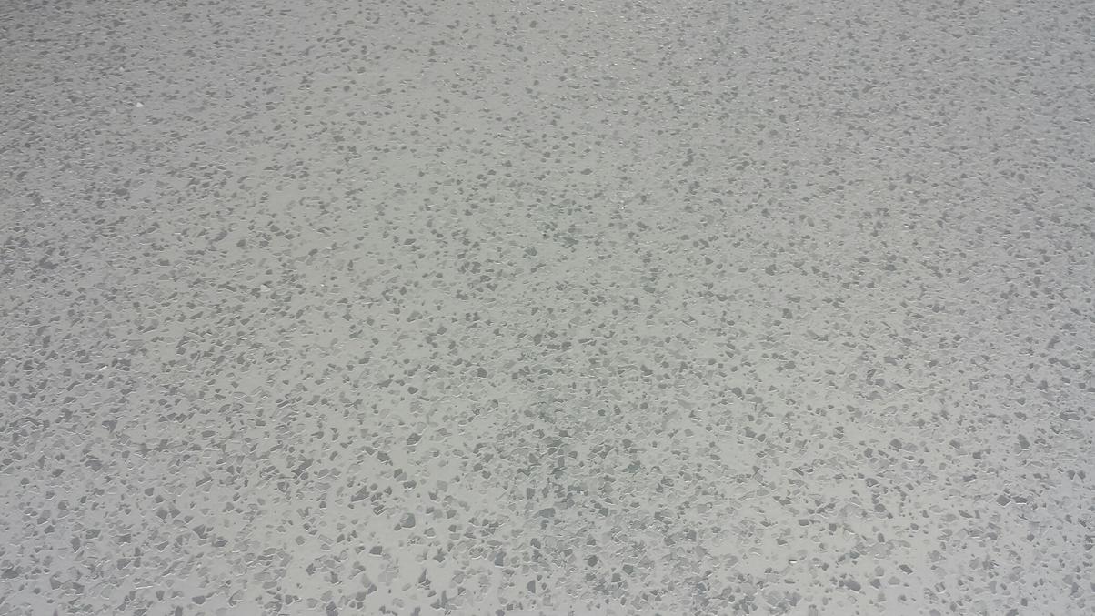

Cool project for the summer. Total cost, $565 & 8 hours labor for a 600 sq/ft 3 car garage. Already painted the walls & will be upgrading the lighting later.

Never used Rustoleum, but I'd do a little research first. I used Armorpoxy Armorclad, but there are several really good 100% solids epoxys out there to fit your budget/needs.

Dawudih's floor looks like a $3000 professional job. Amazing.

There are several good 100% products, mine is Armorpoxy's Armorclad. It's the stuff dealerships & warehouses use. Probably overkill, but I figured this would be my house for the next 15 years so why not.

Ditto on the prep work. Don't skimp or take shortcuts or it will lift/peel. Use the flakes wisely. The parts that don't get them will be very slippery when wet.

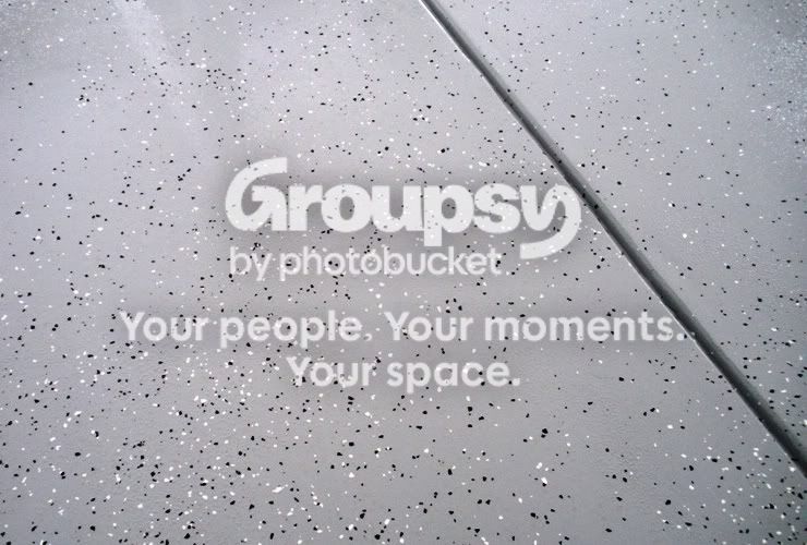

So im confused about something. You dont appear to have any expansion joints like i have in my garage.
Did you never have them or were they filled with the epoxy job?

Sorry for the late reply; spent a couple of weeks in Colorado & there's no internet or telephones up there.
I've never seen a house or garage with expansion joints in Texas; maybe because it's built using a solid slab reinforced with fiberglass, rebar & high tension steel cables, but I can't say for sure.
The company did ask if I had grooves/joints though & they did recomend leaving them alone but did have a filler available.
