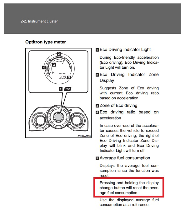

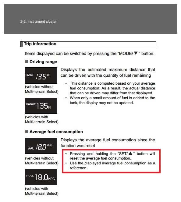

Have you tried resetting the MPG calculator and running a few tanks through to see if it's back to normal? I doubt you can actually break it from doing what you did though, so don't worry too much :)
Because I know we're all allergic to reading the manual, here's two ways to do it, and of course pulling the battery like [MENTION=77504]mace.[/MENTION] said works too.

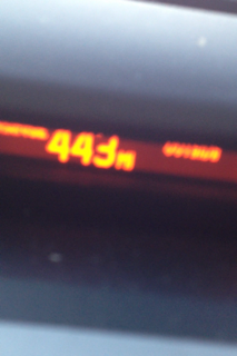

BTW, I think this is my highest yet.
It was at 444 but I snapped the pic a few seconds too late. The damn thing doesn't recalculate until you start driving...I think.
