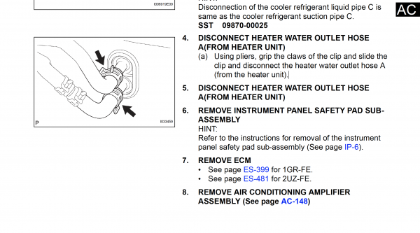

FSM simply says "Using pliers, grip the claws of the clip and slide the
clip and disconnect the heater water outlet hose A
(from the heater unit)."
It took a lot of twisting, but I finally got them to come off. I deformed the bottom one a little, I'm hoping it's not going to be an issue, I really don't think it should.
