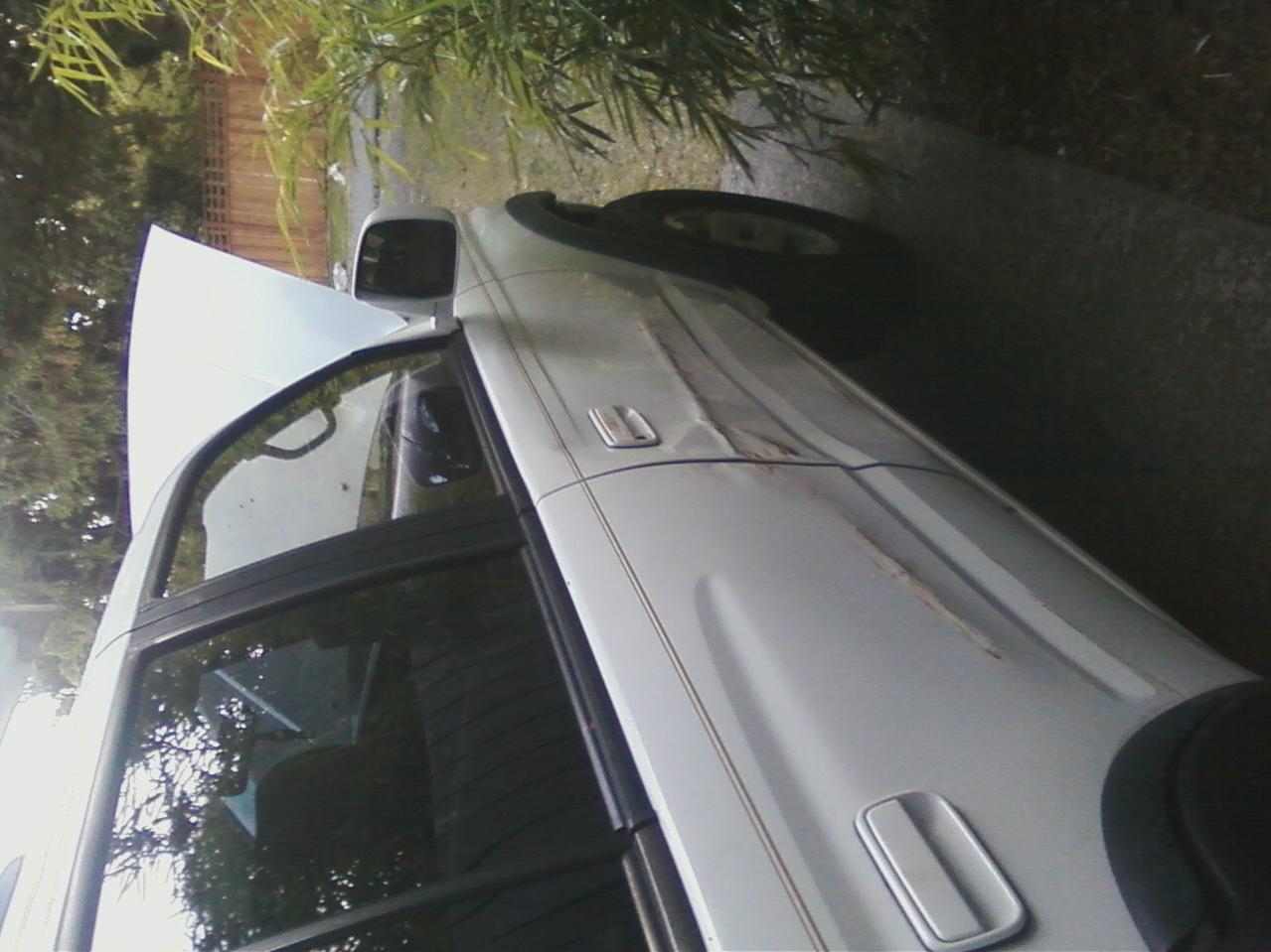

The interior is the only part of my runner I keep clean and smelling good. The outside smells like swamp and looks like hell. Maybe while the door panels are off Ill pound out this dent
