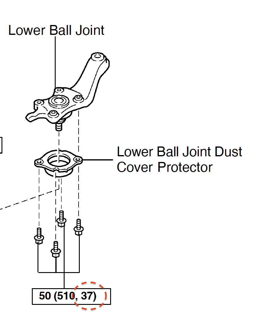

so wait.. the illustration from the Service Manual states "37ftlbs". But I'm hearing torque it to 59ftlbs?

This chart alone explains why Toyota specified a torque of 37 ft-lbs for the Black bolts, as opposed to 59 ft-lbs for the others - it's not that the bolt is weaker, as some have speculated, but that it reaches the same preload (or higher) at 37 ft-lbs as other bolts do at 59 ft-lbs. So, conclusion number 1 - if you use the Black bolt, do NOT torque it to 59 ft-lbs, you will yield the bolt. Torque it 37 ft-lbs and be happy.
Using my spreadsheet for estimating torque to preload ratio as a function of bolt geometry and friction coefficient, the data above suggests that the friction coefficient is about 0.15 to 0.2 in all the bolts except Black; the Black bolt friction coefficient is likely below 0.1. That puts it squarely into dry film coating territory, which I think explains why it performs so well, wears so little, and has the smoothest rotation (by far) of them all.
My theory all along here is that the bolt with washer has a different acting friction diameter than the flanged bolts. Smaller head = lower torque for the same clamping force. I don't think the black bolts are coated with something magical that changes their coefficient of friction - to the contrary, I think they are specifically not coated with any friction reducing compounds, unlike the other 'color' bolts where Toyota was tweaking coatings to tweak preload in later years.
Toyota likes the flange bolts because they are cheaper, but they couldn't use them with the dust protector due to the torque that would be applied to the in-molded metal sleeve in the protector. They went to a bolt with washer and adjusted the installation torque for a (near) matched preload.
LBJ Bolts (4 per side) 90080-10066 (96-00)(59 ft/lb)(flanged bolt not for use with dust protector boot) or 90119-10933(01-02)(37 ft/lb)(bolt w/washer for use with or without dust protector boot)
That may be part of the story, but not all. The contact diameter on the ARP washer is 16.2 mm, and the one on Black bolt is 14.8 mm. That's only a 10% difference. Plug that it into the full torque vs preload equation (not the mickey mouse simplified online calculator), and the difference in preload at a given torque is about 4-5%. So that won't explain why the Black bolt generates almost twice the preload of the ARP bolt.
We won't know for sure without an FTIR machine. But the data suggests that there is some kind of a friction reducing coating on the Black bolt. I don't think I stated that it is magical, just that it is good.
