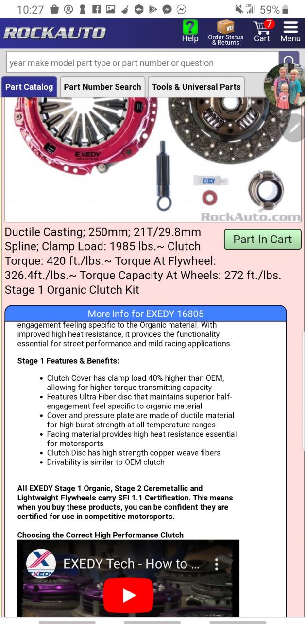

Charlie: this is a screenshot of the info on the exedy clutch. I think it's the friction material not necessarily the backing plate. However my knowledge on manual transmission clutches is extremely limited.
LOL, that image specifically says 40% more clamping force from the clutch cover (pressure plate). So, it is an organic (similar/same to OEM) disc with an upgraded pressure plate. That'll be fine - but unless you are doing a power adder isn't necessarily needed.
