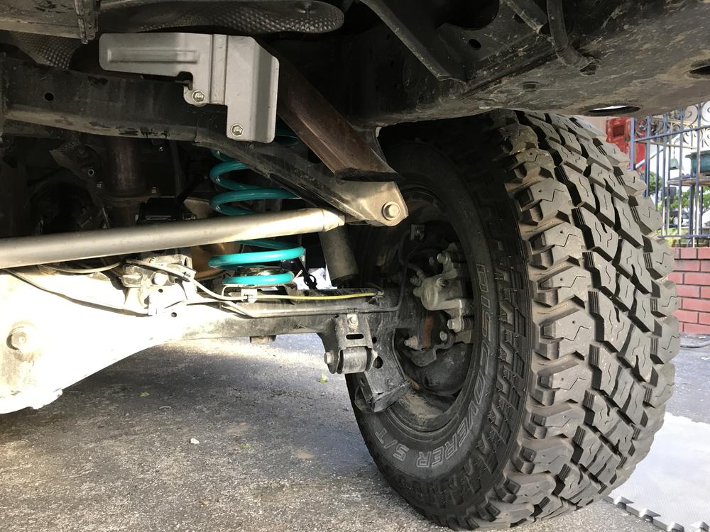

Tried searching but could not locate anything. What is everyone doing with their tailpipe when installing a high clearance rear bumper? Is everyone cutting and rerouting or is there a better alternative? Just trying to prep in advance.
I just finished doing this to my exhaust, I cut it about 2 inches out from the last hanger. The exhaust pipe now sits tucked out of the way. My exhaust has been bent and kinked so I think mine actually sits higher the others with the SSO bumper. It was really easy to cut with a sawzall.
Cut off at the track bar mount.
