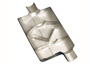

It appears that flowmaster has a slightly more restrictive design than the magnaflow and vortex (which is more of a straight flow-through). From what I've read, some back-pressure is needed for low-end torque. But I'll see how it goes once I get it installed. In the end, I just need a new muffler, and I just want to change it up a bit--instead of keeping with a flow-through design, I want to see how a 40 series flowmaster will sound on the 4runner.
below is a photo of the internal of a 40 series flowmaster, keep in mind the inlet is at the bottom-right of the photo.

For those who have just replaced the muffler, what is the piping dimensions for the 4runner? 2 1/2" inlet/outlet? And is it center in offset out or what?

2.25" inlet center & 2.25" outlet offset, or inlet offset / outlet center
