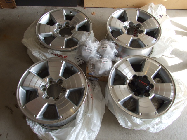

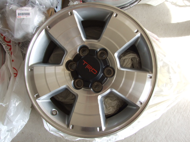

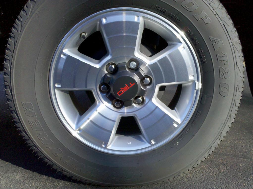

I purchased 17" Tacoma rims to be used for winter tires 265/70R17. It is 7.5 inch wide and 30mm offset.
Following the formula below (TO CONVERT OFFSET TO BACKSPACING):
For positive offset wheels: (Wheel Width +1)/2 + (offset * .03937)
SR5 OEM 17" rim offset = 4.59 inch
TACOMA 17" rim offset = 5.43 inch
This is almost an inch offset difference. Should I be concerned (i.e. need wheel spacer) ?
Thanks in advance for your expert opinions.

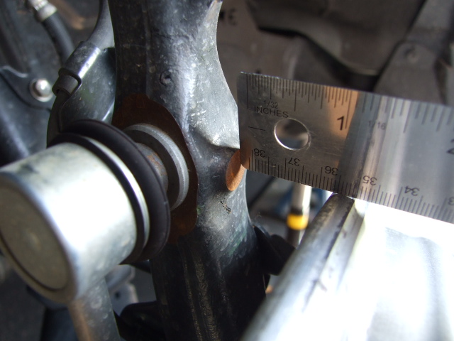

The offset on the Tacoma wheel brings the tire in closer to the upper A-Arm and may rub.
You would probably need to get 1 1/4" wheel adapter to make the offset 4.18"
I mounted the Tacoma rim and measured the clearance, approximately 1 inch. With the tire mounted, looks like there will be an issue.
Thinking of two options, 1.25" Spidertrax Wheel Spacer or sell these wheels
:crybaby:
