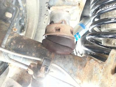

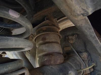

So I've looked around trying to find a nice soft rear bump stop that's got enough length to keep my LC shocks safe. I saw a few guys using bump stops off 95-05 Jimmys, Blazers, and Bravadas but the rubber density seems to be inconsistent.
My search has hit a dead end with pretty much these as being the only option out there. My stock bumpstops are hard as a rock or I would sandwich a piece of 2x2 in there and be done with it.

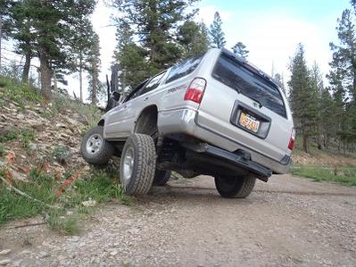

Here is bigfish's flex shot with bump stops mentioned above http://www.toyota-4runner.org/3rd-gen-t4rs/134139-junkyard-rear-bump-stops-2.html#post1472323
And here is Mahalas http://www.toyota-4runner.org/3rd-gen-t4rs/134139-junkyard-rear-bump-stops-2.html#post1816970
Pretty large disparity wouldn't you say?
Polyurethane is probably only marginally better so I was hoping someone had a cheap solution with rubber bump stops.
Anybody go a different route than spacing stock bump stops or using polyurethane?

The ~3" spacer that he's got installed between the frame mount and the bumpstop might explain that large disparity.
Just sayin... :noidea:
Haha right but I thought the spacer was added because they were too soft.
From what you're saying I gather your blazer bump stops would do the same if you added a spacer...gotcha

Poly gives just fine with the gaps. The truck weighs a lot. Also I have those stops and they are a softer type of poly compared to any poly motor mount ive installed. They work great. No harsh slam down like with the stock mounts.
If I could do it again I'd make the extension a little longer at least 1/2 inch.
Originally I tested empty on flat ground with a fork lift. Last trip I found my self flexed out hanging a tire with full wheeling gear + hunting stuff and gas on the roof.
Not sure if the shock bottomed out or if it makes any difference whether its bottomed out full weight or only a little.
