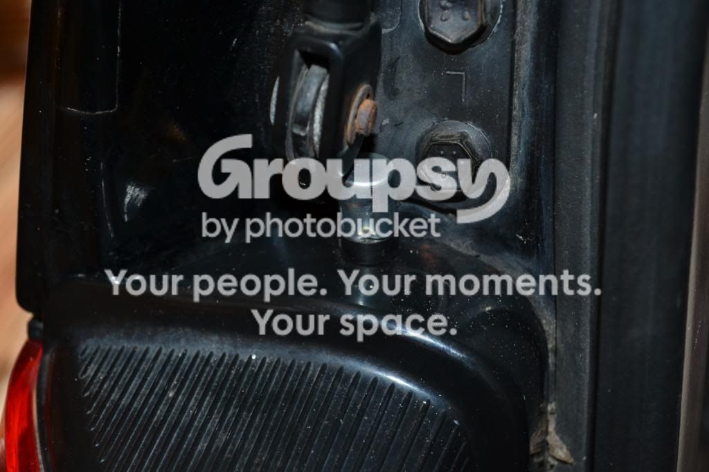

No, you want to route the house somewhere high and out of the way. I have the breather extension on my front diff mounted to the firewall in the engine compartment, and the breather on the rear hose tucked up behind a taillight. Make sure your hoses on the rear axle has enough slack that the axle can droop without pulling it free.

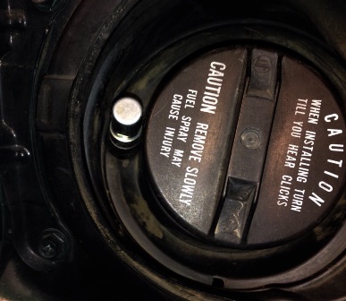

BTW - I mounted the breather valve inside the gas filler cubby - took about 15 minutes to install the whole thing.
