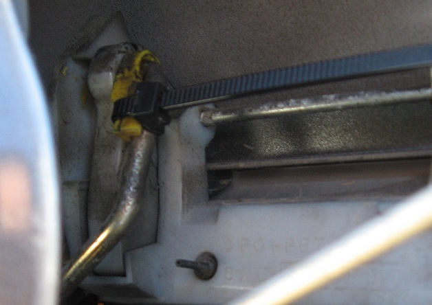

Driver's door will not open. Seems like exterior door handle has disconnected from mechanical gear on the inside of the door. Have the FSM/instructions to disassemble door. Am wondering if anyone else here as done the repair and has pics/helpful tips.

I had to fix mine a while back. A little plastic linkage piece broke so I zip-tied it up and no more problems. Once you pop all the plastic rivets out and unscrew the 2 screws by the inner handle, there's a lip on the top of the panel that "hooks" the panel onto the window area. Just lift straight up once the panel is loose.
Also, just push the door handle through the door panel when removing the panel instead of removing the handle. I had the same problem, zip tie has been in place and working for over six months now.
You will need to take the door panel off and see what is up in there. It could be like the guys said, the the plastice clip broke and you can zip tie it. In my case the handle had broke and therefore I have to replace the handle completely. Try and make sure you get the same year if you need to replace. The first handle I had was from a 99 and the door just would not open without putting a little muscle into it, then I got one from a 97 and the same color as my truck and it worked out perfectly.

The fix was simple. Just used a zip-tie like you said. Attaching a pic for anyone who has this problem and searches the thread for it.
