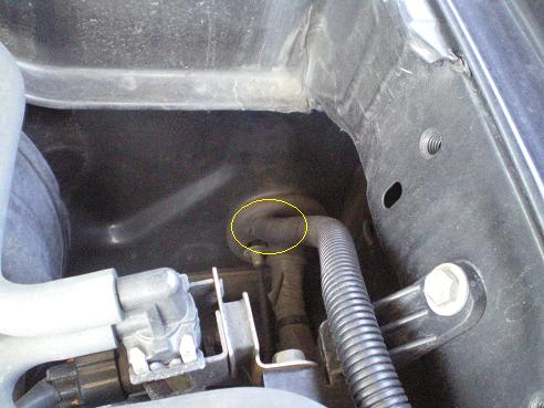

you can drill a hole where the clutchplate is (assuming you have an auto) and use the appropriate grommet to put the wire through it.
As far as your tweeters, if you have factory tweeters you can adhere the aftermarket ones right up behind the grille of the factory tweeter cover. If you do not, you will need to use the supplied tweeter mounting cups and mount those somewhere, and install the tweets in them.
I did the same thing riceandpho probably did with the grommet on the driver's side. Very easy to get to and I had no problem punching a 4 gauge through there.

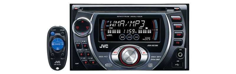

Yep , I have the factory tweeters in there . I have been scratching my head over getting a Scion HU and today I decided to grab the KW-XG700 from JVC . Install was EASY !! It sounds great , has 2 pair of pre-outs PLUS a set for sub out . It really looks very good in there . Sounds great ! Plus it actually has a knob to turn , for the volume control , being "old school" , I like that :)
Power Output: 200W Max. (MOSFET 50W x 4), 20 X 4 RMS
Double DIN
Ready for Bluetooth
