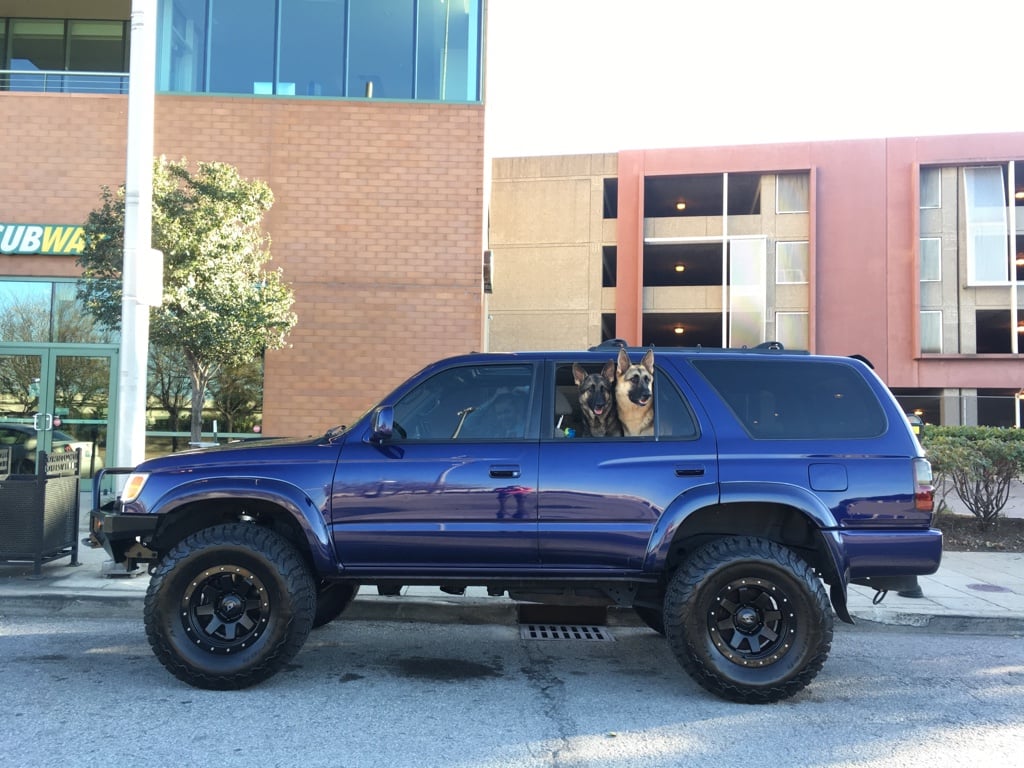

Every since I installed the superflex rear coils with extended bilsteins, I wasn't happy with the rear shock mount being a massive pain in the ass to get to to install the shock.
I've seen a couple threads here and there but nothing with a definitive company that build these kinds of things.
What shock mount would work best, if any, with my extended bilsteins?

He also is running resi shocks that are a lot bigger than regular bilstein 5100 shocks. Plus, he's running 35's, I'm only running 33's.
His resi shocks are still 2.0 shocks like the billies. It is definitely do able but the clearance will be very very tight even with wheel spacers if you have a longer shock. It wouldn't be very difficult with a shorter shock but at that point why go with a shorter shock when you could just go inboard and not notice much difference in dampening but still gain more wheel travel than the travel of the shock. Try googling "3rd Gen 4Runner Outboard Shocks" you'll get a few good threads
You and this Google machine. I'm telling you it's never gonna take off. Just kidding, after searching it up I think I'll keep my stock mounts as the positives don't seem to outweigh the negatives for my runner.

The whole outboard thing is a real PITA making sure you have the clearance for your shocks between tire and frame. Almost no room up there, especially when flexed. The longer the shock, the harder it is to fit (almost exponentially). Since the axle will be at a higher angle when flexed, causing the tire to lean in toward the wheel well more. Getting a nice shock and mounting it at stock location is way easier to do and not much performance is actually lost this way.
