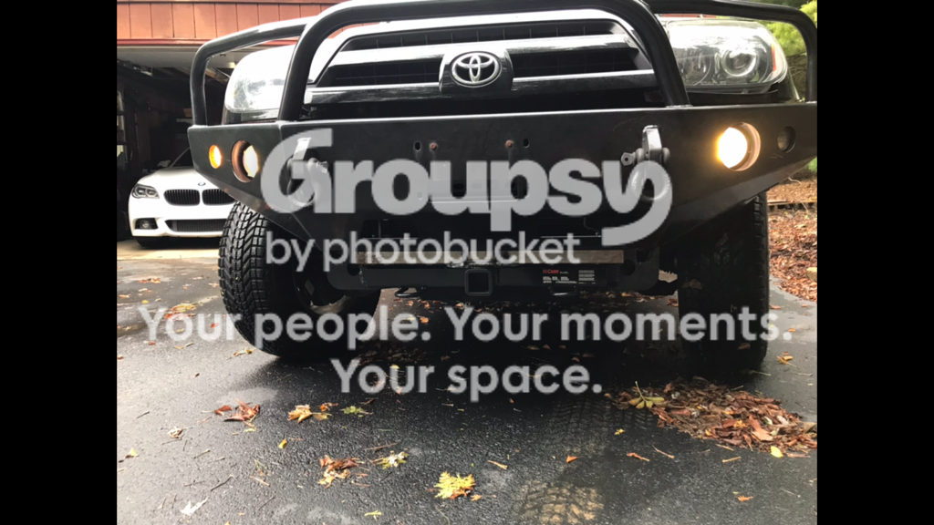

Fabbed up front mount hitch for 2003 T4R
PeteZ06

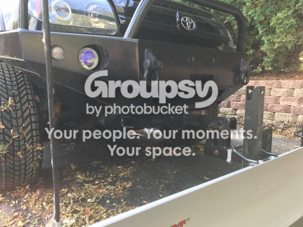

Since no one sells one for this year model and nothing seemed to work with my front bumper.. my neighbor and I did some fab work to make it work.
Ordered a Curt front hitch for a 2007 model.
Used the 4 mounting points that mount to the frame and used a spacer between my bumper and hitch to beef it up. Not the prettiest but it works, will paint the spacer bar next weekend.

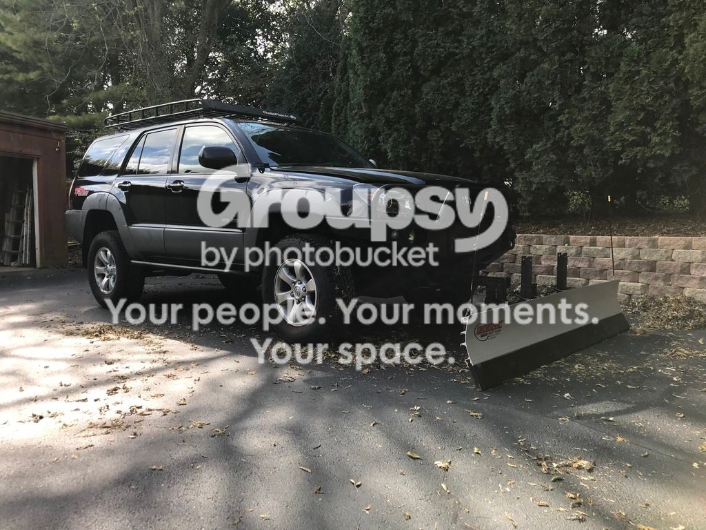

I need this mostly to use for my SnowSport Snow plow.
No more pushing snow in reverse!!
