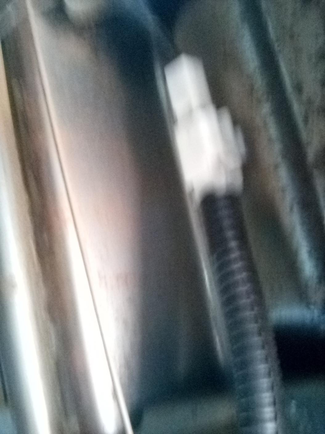

I don't see either button. I have a -97 3.4 manual transmission (don't ask me why a manual tranny needs a car alarm). Anyone have a pic of what I should be looking for?

Your 97 should be under the drivers seat. It’s different than the 99+ alarms.
So is this what I should be looking for? It was the only thing I saw underneath the driver's seat. No button, but a connection that I guess I could unplug?
This is the OEM remote security system for my 97 Located under the drivers seat. The green button it the button used to select different modes. Teach included.
This is the manual
It the factory remote isn’t under your drivers seat you have an aftermarket.
