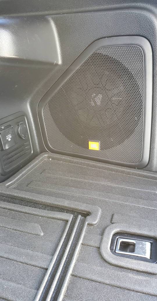

[MENTION=94527]bboy626[/MENTION] thanks man!! That's the picture I couldn't find after hours of forum searching..not too bad, easily can be hidden with a cover or something to "tidy it up" and keep the dawg's paws out of there. Big help.
[MENTION=51033]97BlackAckCL[/MENTION] I've gone through your build a few times lol, the open panel looks great tucked away in that small cubby with the liner but unfortunately my exposed pocket flows up the whole side of the cargo area

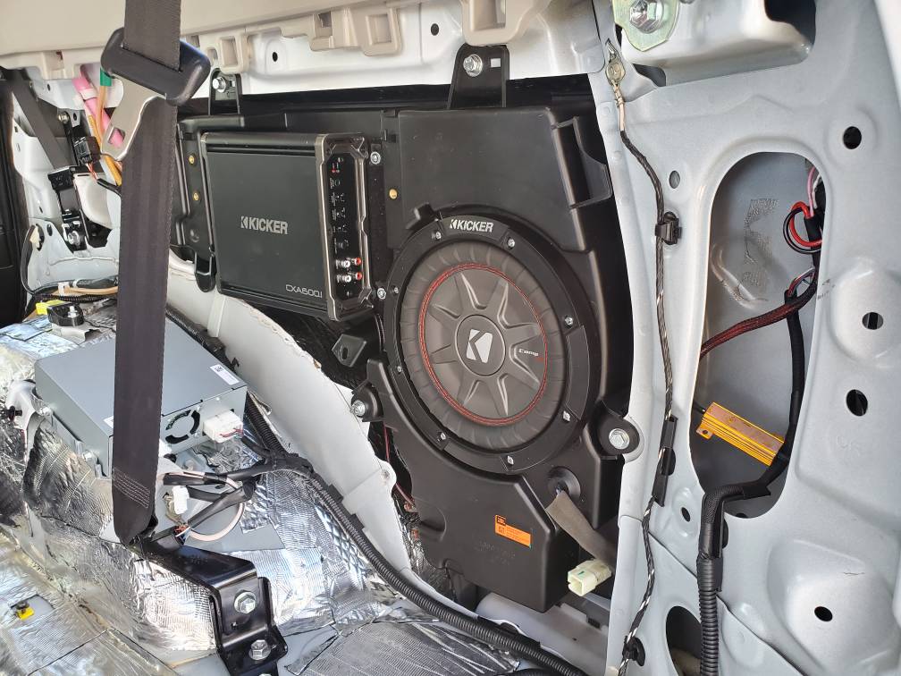

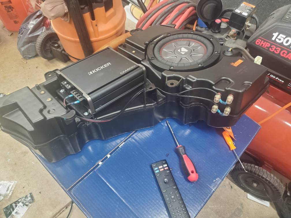

I've got the amp going in just after Christmas and have the Kicker 48CWRT84 Shallow Mount 8" on the way for the swap. I'm going to bridge the rear 2 channels on a 4 channel amp and run about 200W to the sub - just what I need. Front 2 channels will be powering the Kicker 3-way 6x9s in the front door to round everything out. Won't be a perfect solution coming from a true five channel/LC7i/10" system in my F-150, but I think it'll scratch the itch on a budget without taking up any storage room.
In terms of pulling out the rear panel and installing the JBL factory box, anything too cosmic to look out for? All of the videos and step by steps I've seen have the third row (I don't have it), so I'd imagine it would be a different process to yank it out. I'm still in the kid gloves phase so trying to understand what I'm doing before I start pulling out body panels.

I just removed my rear panel in a 2016 Trail no 3rd row. You have to remove the rear passenger side seat 3 bolts and the hinge that the seat rides in traps the panel so you have to remove that as well. You also have to pry out the recline lever and there are two bolts in there that need to be removed. I had to remove that flap in the rear (Two bolts that have the tie downs) and the tie down in the far back passenger side. The panel also has 3 bolts in it that need to be removed. It wasnt difficult but i was going at it blind and was surprised how much i actually had to remove to get that panel off.
Almost forgot the rear passenger seat belt lower bolt needs to be removed as well...
