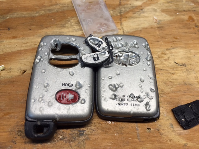

Here's my 2014 4Runner LTD KEY FOB chewed by our dog yesterday(25SEP2015). all the micro switches(buttons) are broken..so the electronics is gone..though the key itself is still good.
Today; Price quote for the remote from a dealership here in Chesapeake VA was $183, (if I needed the key, would have been another $80) BUT they matched the internet price for an OEM of $135(Remote only). and the programing to my 2014 4runner is $83.
