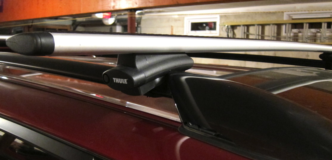

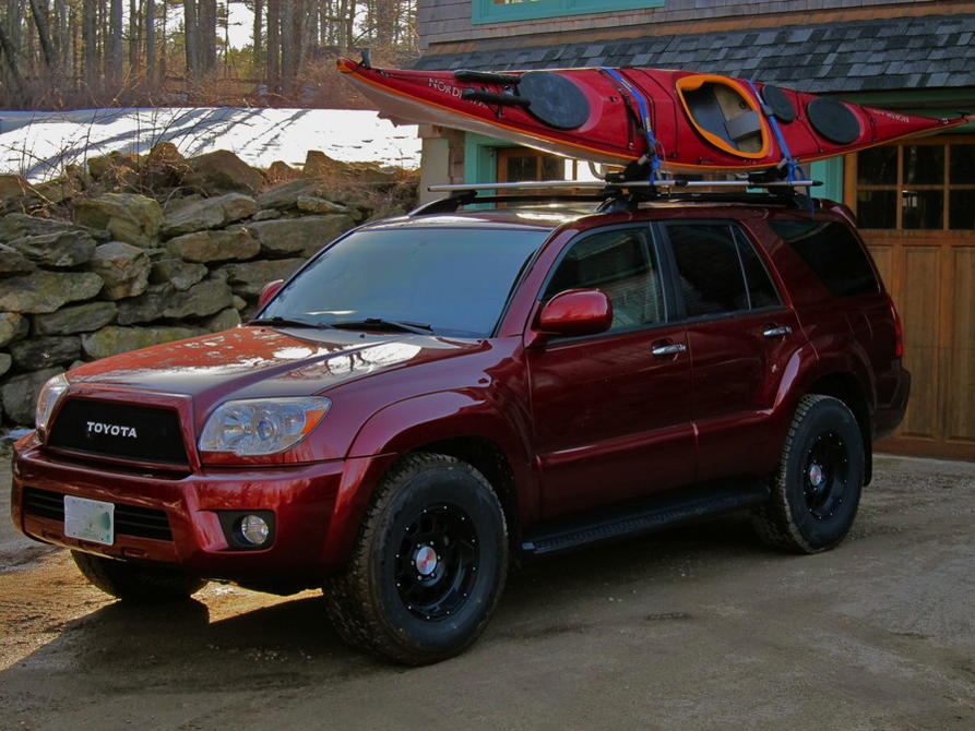

I have mounted Thule Aero Bars for hauling multiple kayaks. No movement at all at highway speeds with 2 or three 18 foot boats up there.
Not sure why OP feels the rack is useless, I actually would give it high marks for construction and strength. (talking about the standard SR5 roof rack)

Hey Ken, I just ordered the Rapid Crossroad Foot Pack; they clamp to existing rails and then ordered a couple 53" AeroBlade load bars to go with them. The set-up is really strong. Needs to be as the wind forces on those big boats can get severe.
