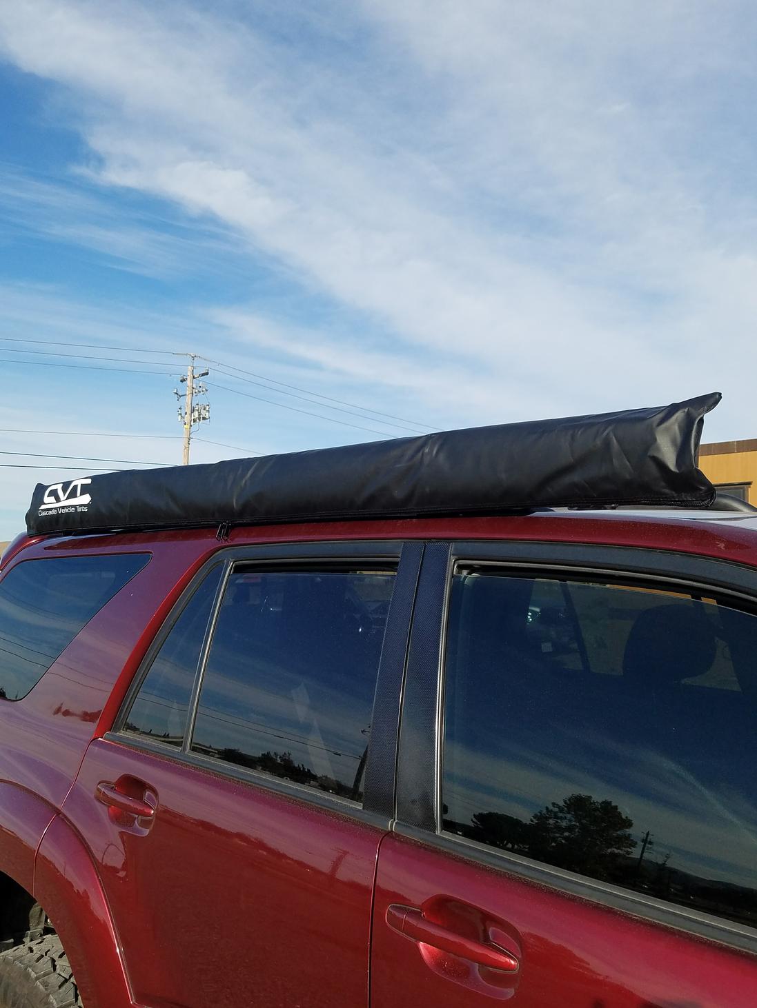

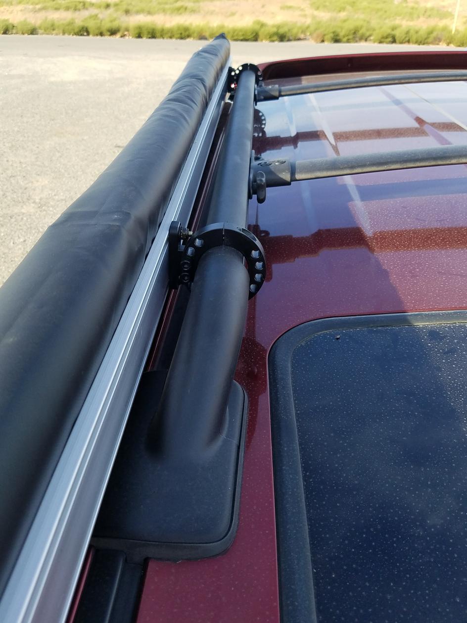

Modular Awning Mounts

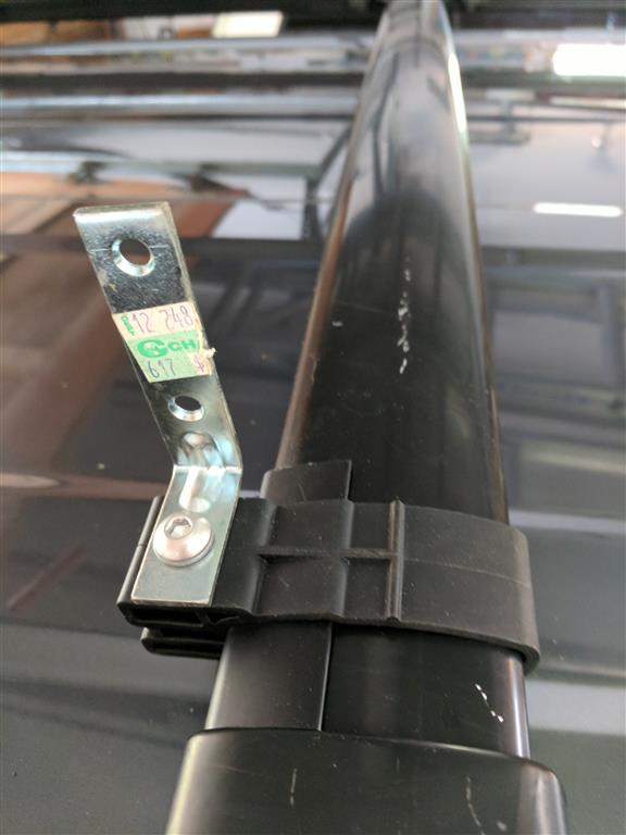

My solution - 4 years later
It is now 4 years since I posted the "Useless" thread. Well, I still have my 2007 SR5 and never did anything about the roof rack until today. I had considered expensive racks and accessories but I really wanted to solve a simple problem cheaply. Occasionally, I want haul some lumber, long pipe or a ladder and always struggled with how to stabilize the load from shifting left or right. I was always concerned that my load would slide off the rack when making a turn. This is what I did.
Based on feedback from others (thank you). I went to Amazon and bought some Yakima MightyMounts(23h) which fit my gen 4 rack pretty well. These are sill available. I had considered the new universal mount but they looked like overkill. I had some old 3" corner brackets (with Channel Lumber stickers, anyone remember Channel Lumber from the '80s?) in my junk hardware drawer. I used a 5/16th bit to drill bigger holes in the brackets to fit the bolts that came with the might mounts. I cut
the brackets to fit the width of the mounts and mounted them on the rack. With the 4 mounts, I now have stabilizers for both left and right and they can be adjusted left or right across the rack to fit the load. The mounts fit pretty tightly. Total cost = $28.00 plus tax. My rack is now useful.
Thanks to all for great ideas. Happy hauling.
--Ken
