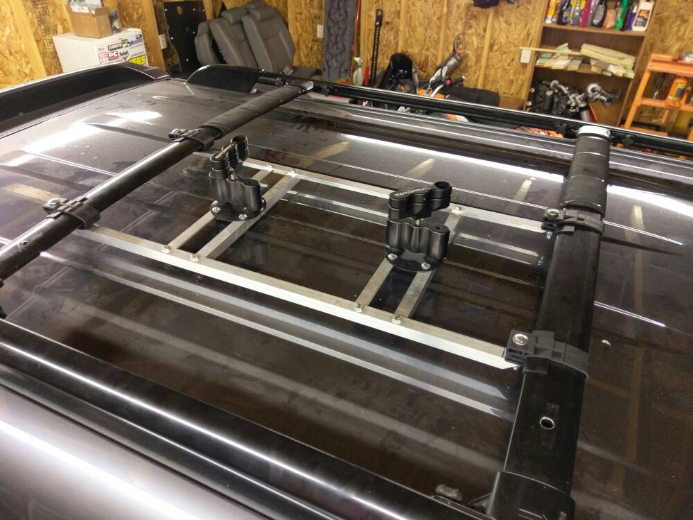

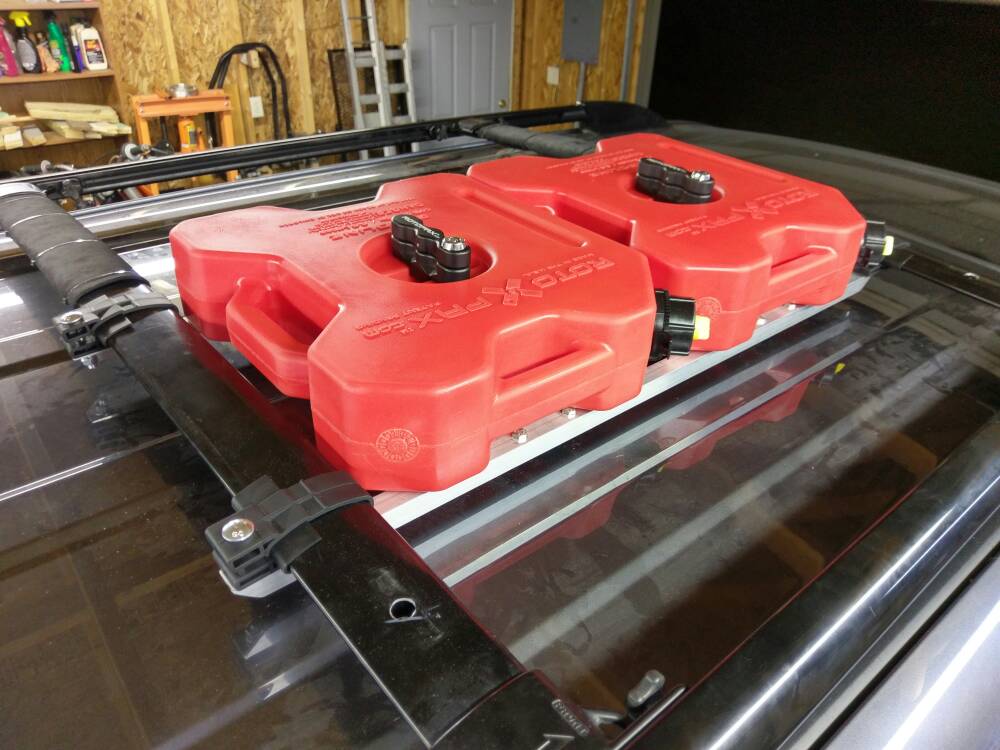

Stock rack with tred pros mounted with rok straps, neoprene wrapped the crossbars to dampen any rubbing/sound.
2 1.75gal rotopax on locking mounts, home made aluminum bracket mounts to underside of Yamika mighty mounts for a low profile mount.

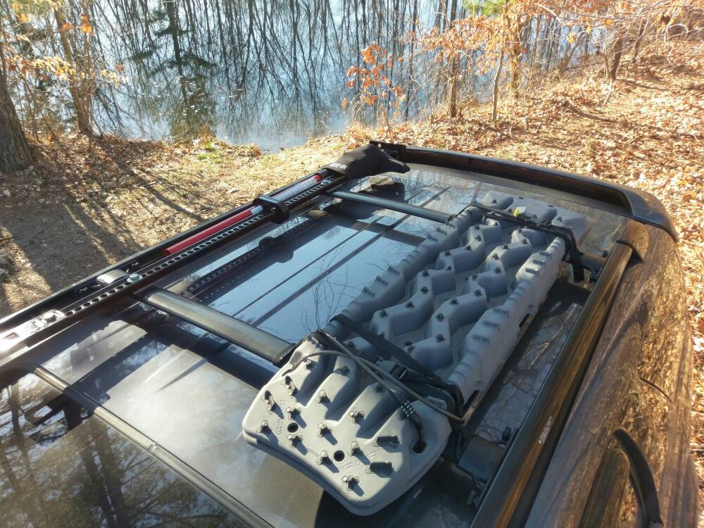

60" hi lift mounted straight through the stock cross bars. I can confirm that they do in fact have aluminum structural supports inside of them.
Watchya using for the hi lift setup? I was trying to use those might mounts and it just didn't feel solid with the high lift. Works great with the maxtrax though, bolted in the corners. Very interested in the specs of your setup. What size hole is that?
Hi lift mount was 1/2" holes drilled through crossbars with 1/2" bolts down through, wing nuts on the bottom. Secure and tool less. Lock it with a cable lock.

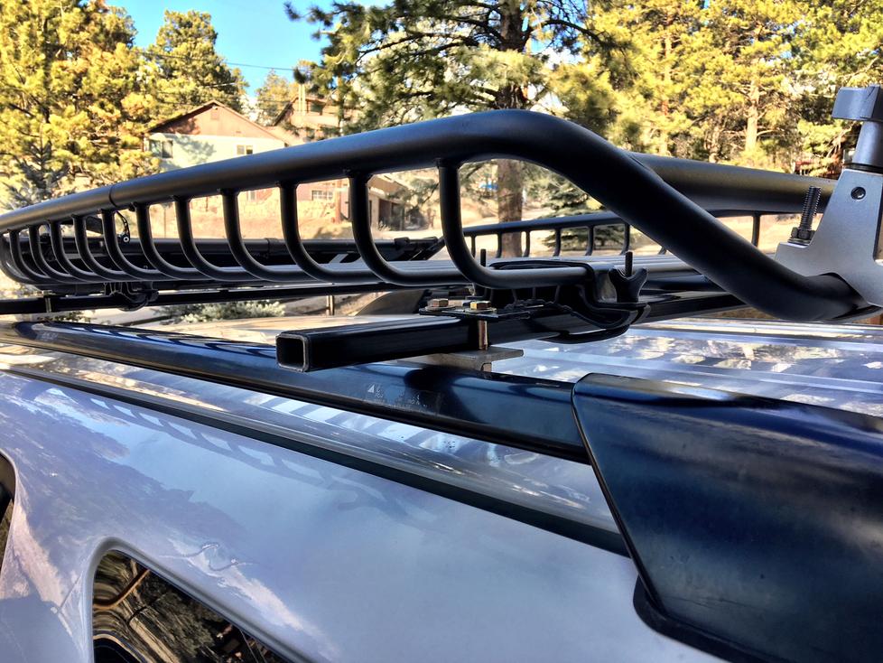

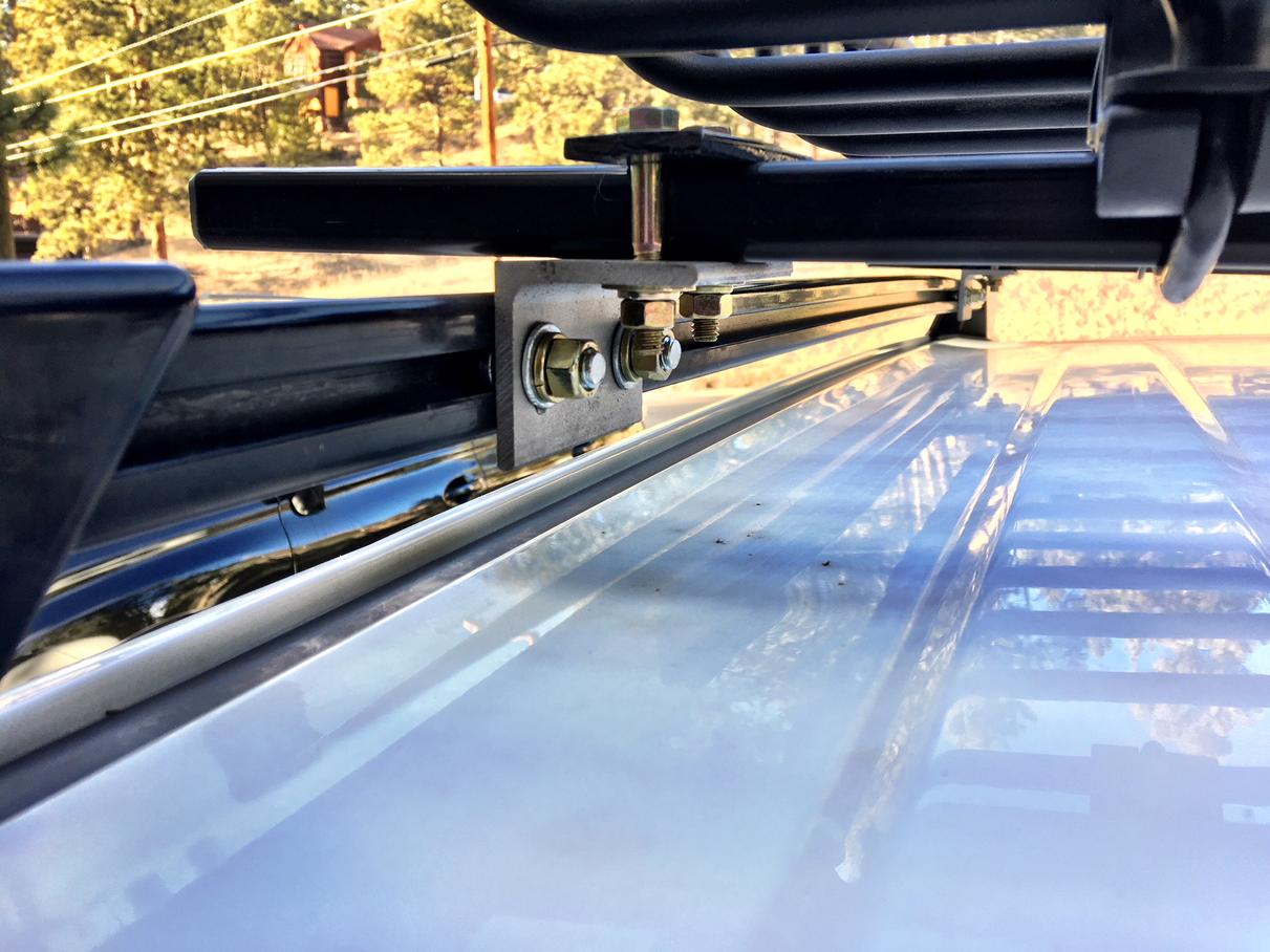

One option for the factory roof rack is to make crossbar mounting brackets and use Thule or Yakima cross bars.
I made these out of high-strength stainless steel angle iron, grade 8 bolts and 3/16" steel flatbar. This allows the crossbars to be mounted much lower than the Yakima or Thule mounts, and it only cost about $70 for the mounts vs $200.
Very nice! I might try to copy that.
So how did you capture the bolt head inside the track to tighten it down? Slip a wrench into the track?
The carriage bolts have a square section at the base of the bolt that fits perfectly in the track, so it doesn’t spin as you tighten everything down. I did need to add a thin washer behind the track so the square base didn’t extend past the track.
