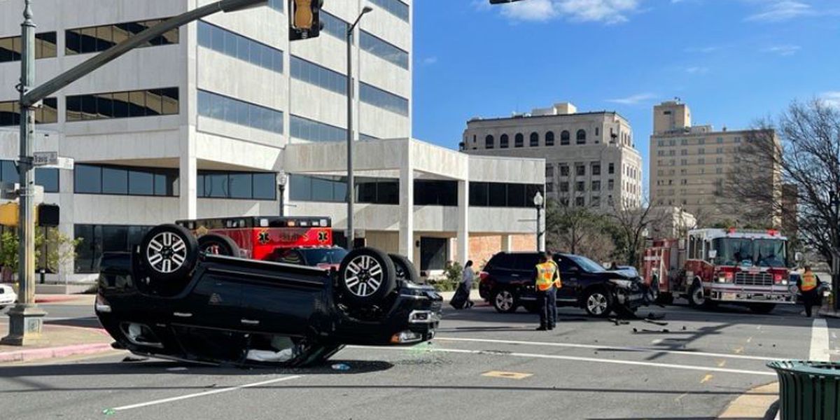

If you are questioning the strength of your pillars see the attached pic.
Waaaw, I think this pic fully settles any kind of worries I had :D

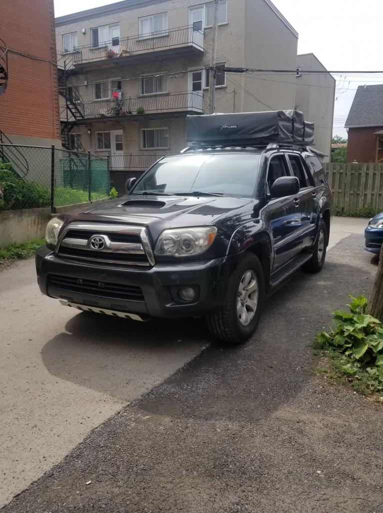

If you dont care about the look, I suggest you to get RTT alluminium crossbars instead of a roof rack.
I paid 50$ for two so I coul install my RTT on it.
Super light and easily removable with a ratchet.
