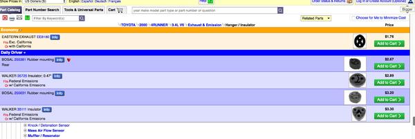

The pricing looks good now, but wait till it's in your cart. The problem with RockAuto is the shipping. It's flipping outrageous and they usually don't bundle items together for a lower shipping cost. It's all separate.
And correct me if I'm wrong, but why not just go to AutoZone or something? It get it, OEM and all, but this is not a part that goes bad often or is at all catastrophic if it does. Beside fitment, there's no reason for the higher price of OEM for this part, and surely something universal will fit close enough.
I hear ya on not needing OEM on something like this...
Have not used Rock Auto in many, many years, but I'll check on shipping.
Exhaust systems droop over the years, so getting this back to factory specs on proper hanging would be nice before something new gets installed.
With part numbers, which I didn't have initially, I'm not adverse to using local auto parts stores at all.
While I might have been able to find them locally, and possibly for less, all five will be delivered USPS Priority Mail for less than 22 bucks.
For those who might be interested:
WALKER 35111 Hanger / Insulator $ 3.30 $ 0.00 1 $ 3.30
WALKER 35725 Hanger / Insulator $ 2.89 $ 0.00 4 $ 11.56
Shipping Priority Mail $ 6.99
Order Total $ 21.85
Thanks again.

And from Amazon with free shipping - for those that have Amazon credits or gift cards to use :D
WALKER 35111
WALKER 35725
Seems like I order on Amazon almost every day! About 10 bucks more expensive this time though, at $31.59 for the set of five...
