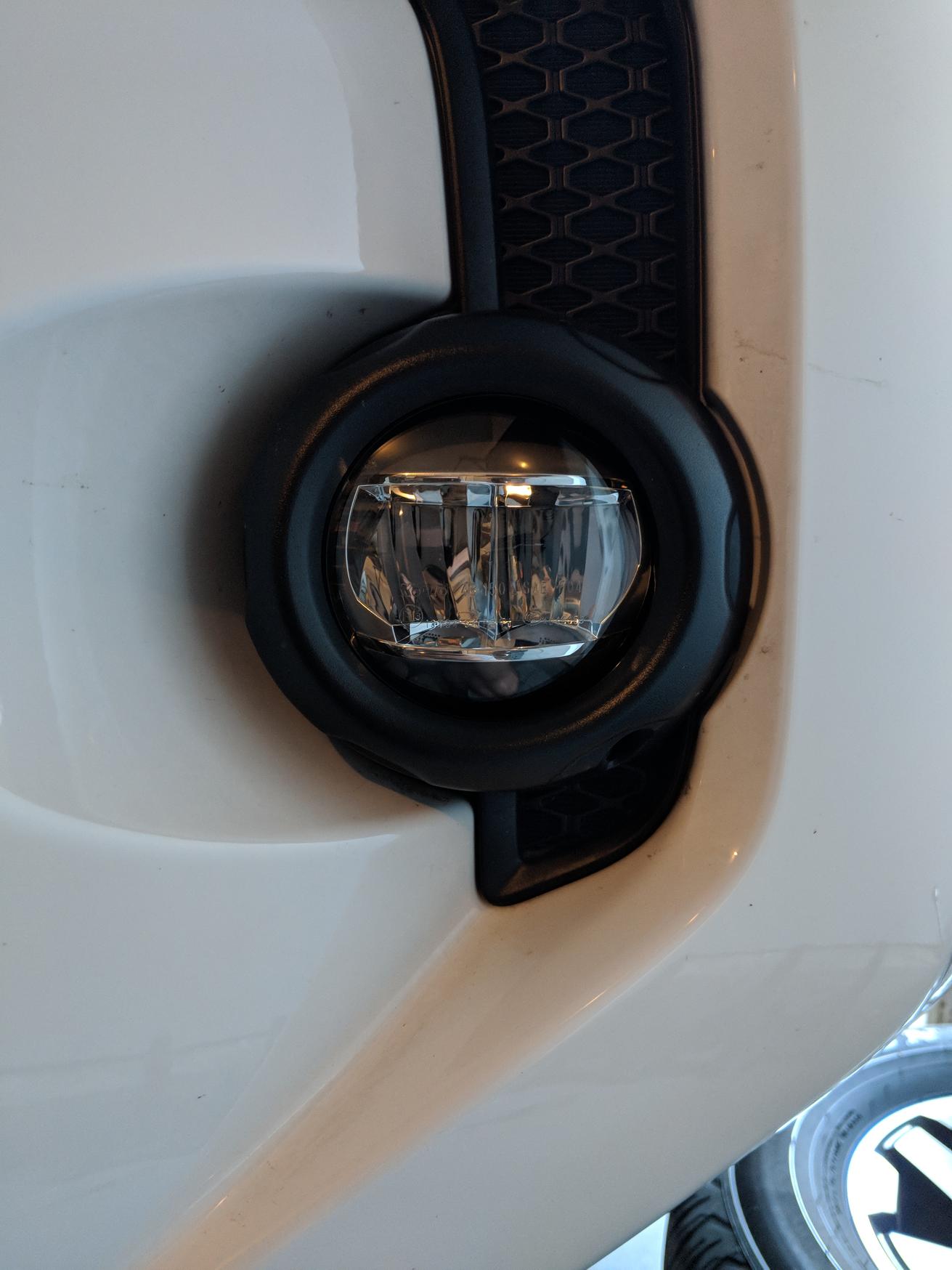

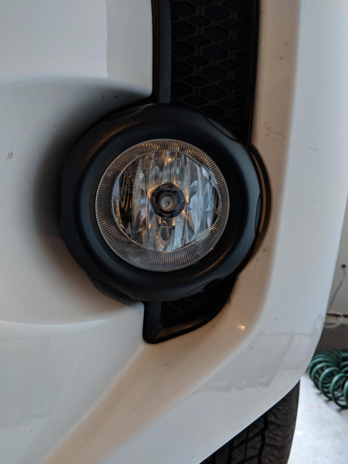

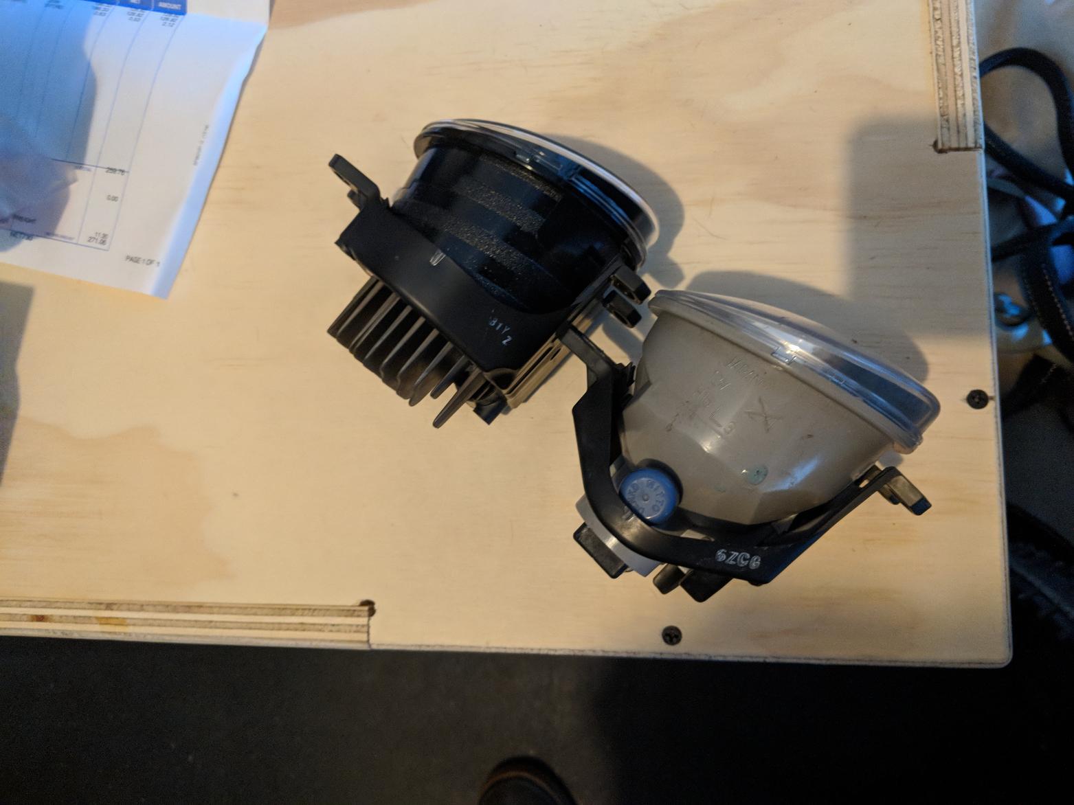

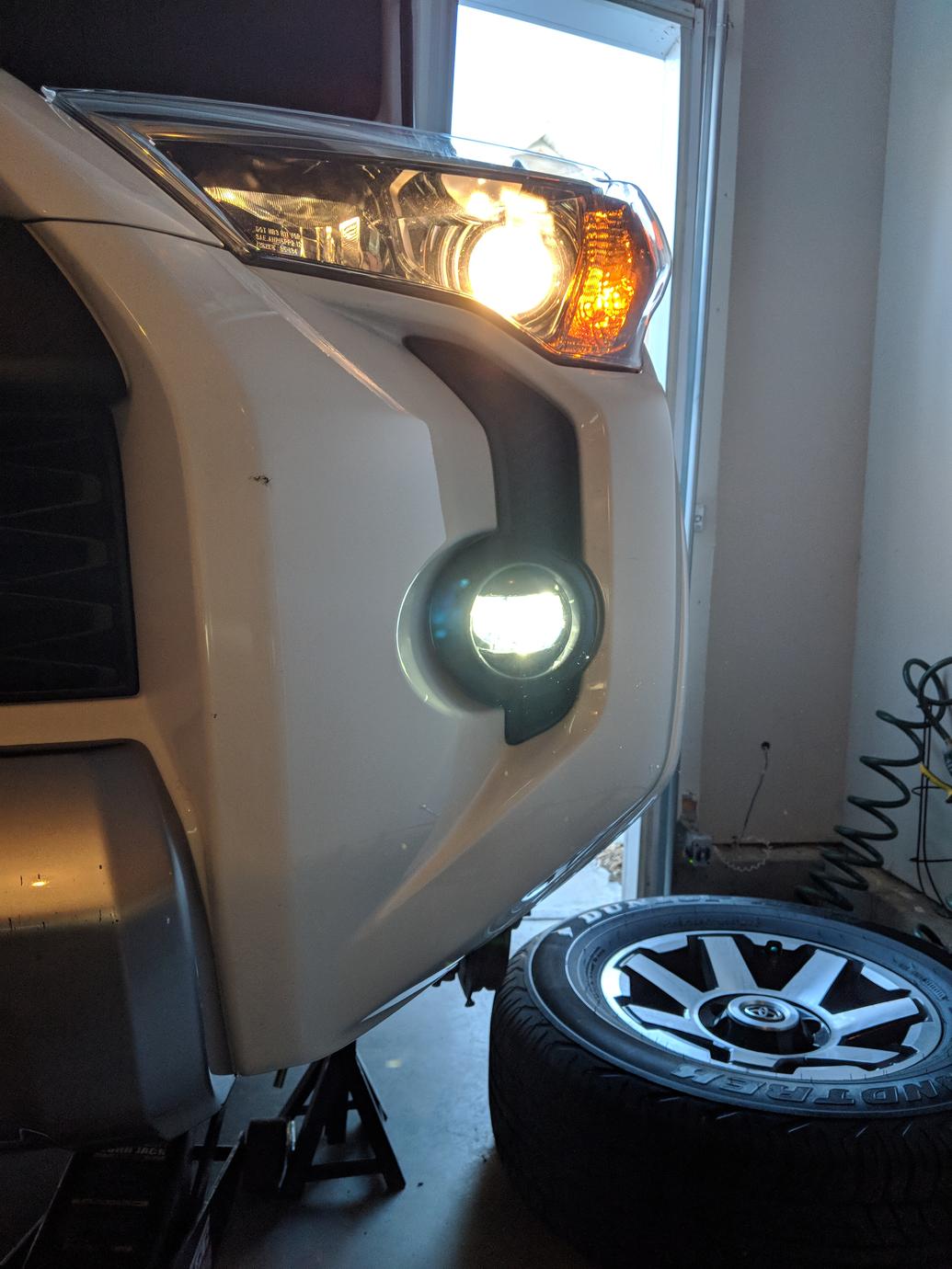

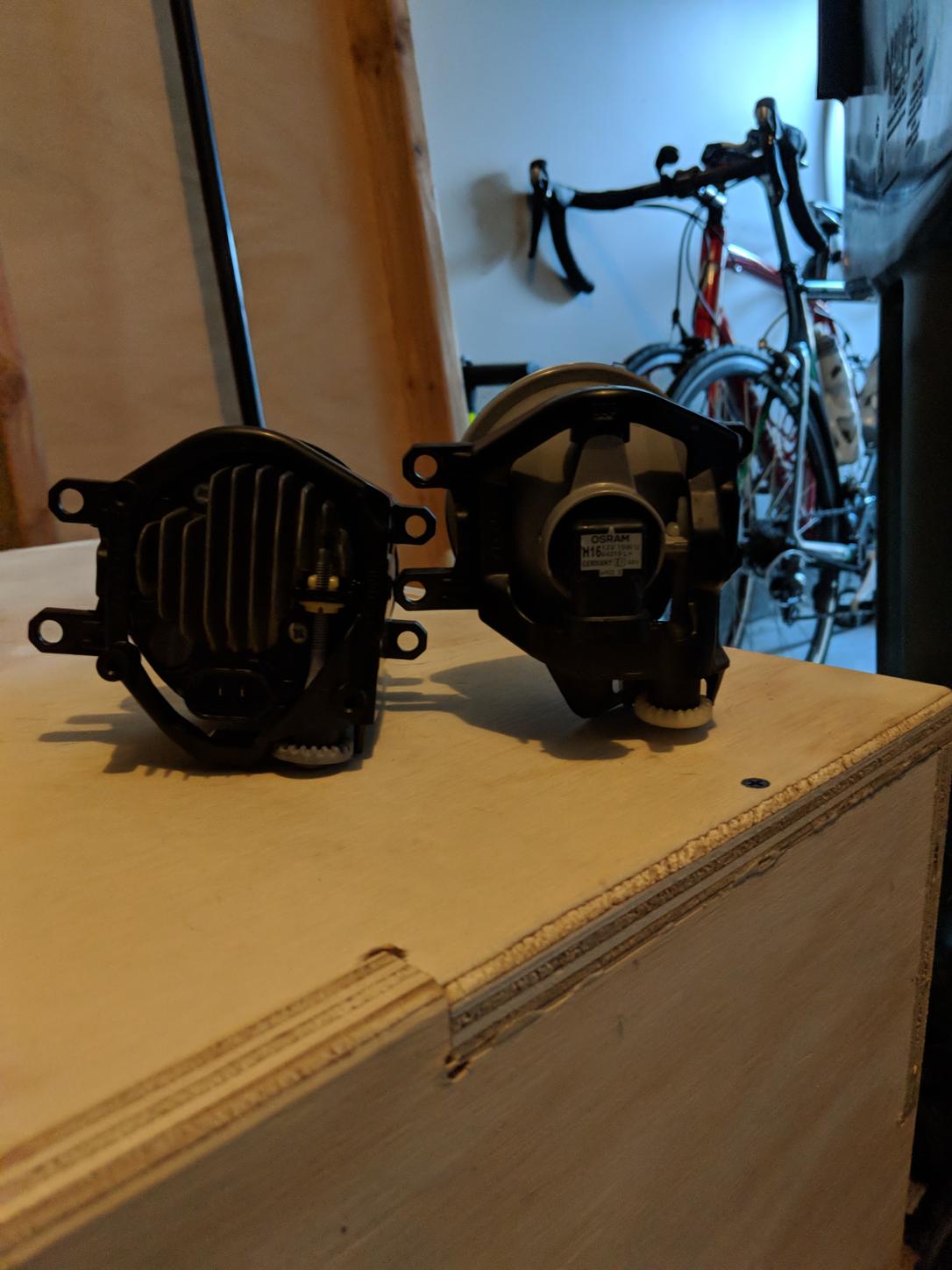

I know the 2019 4Runners will have an option for LED fog lights from the factory. I am impatient and also wondered if the 2018 Tundra LED fog lights would fit in the 5th generation 4Runner. The answer is YES. They are a direct fit and plug right in for my 2017 Off Road.
I prefer using factory parts as often as possible since I'm not doing any heavy duty offroading. I like the look of factory and the fact there is typically minimal (if any) modification needed.
I purchased the parts from an online Toyota parts dealer. I shopped around a bit to find good pricing and the cheapest shipping.
Part numbers:
Left assembly 81220-48051
Right assembly 81210-48051
Installation was extremely easy and the results are exactly what I wanted. Now I'll have to upgrade my headlights so the lighting is better and the color temperatures are similar.
Pictures to follow.
These are daytime pics of the LED vs halogen assemblies.

I like room to work so I removed the front wheel and tire before starting each side. You could probably get away without doing this at all on the driver's side. There is plenty of room to remove the two phillips screws holding the assembly in place and get to the connector as well.
The passenger side is a little more involved. It has a cover over the fog light assembly that needs to be removed and it's a pain going in from the bottom. I chose to remove the wheel, remove the screws and plugs holding the front half of the fender liner, and fold the liner back to give me room to work. Again, this is very simple work.
I will update with night pics soon. Unfortunately, I did not take pre-install pics for comparison but I think we all know what the halogen fog light beam pattern looks like by now.

Also, the phillips screws that come out of your old assembly will mount the new so need to purchase more.
I'll post some night pics soon. I'm in college on nights and weekends so busy for me. As for the adjustment, I did need to adjust the beams up/down to be level with each other. Do a form search or youtube search for aiming lights. It's simple.
